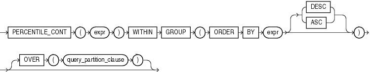

PERCENTILE_CONT
Syntax
Description of percentile_cont.gif follows
See Also:
"Analytic Functions" for information on syntax, semantics, and restrictions of the OVER clause
