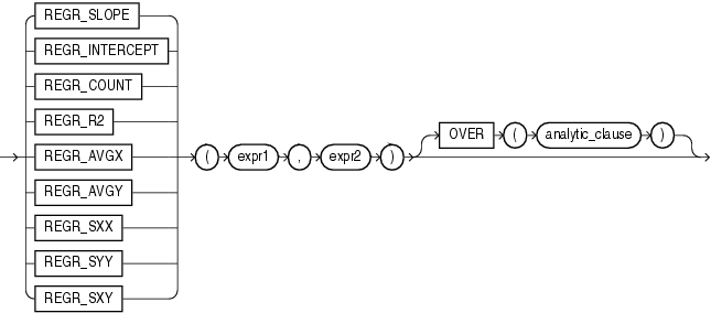

Syntax
linear_regr::=
Description of linear_regr.gif follows
