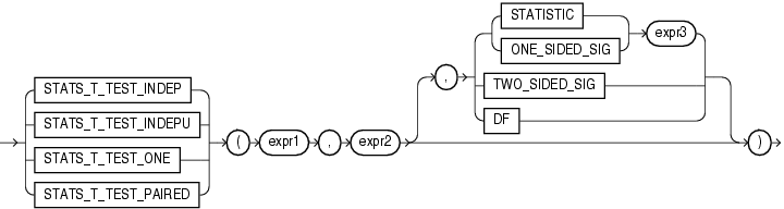

Syntax
stats_t_test::=
Description of stats_t_test.gif follows

The t-test measures the significance of a difference of means. You can use it to compare the means of two groups or the means of one group with a constant. The one-sample and two-sample STATS_T_TEST_* functions take three arguments: two expressions and a return value of type VARCHAR2. The functions return one number, determined by the value of the third argument. If you omit the third argument, the default is TWO_SIDED_SIG. The meaning of the return values is shown in Table 5-9.

The two independent STATS_T_TEST_* functions can take a fourth argument (expr3) if the third argument is specified as STATISTIC or ONE_SIDED_SIG. In this case, expr3 indicates which value of expr1 is the high value, or the value whose rejection region is the upper tail.
