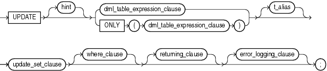

update::=
Description of update.gif follows
(DML_table_expression_clause::=, update_set_clause ::=, where_clause ::=, returning_clause::=, error_logging_clause::=)

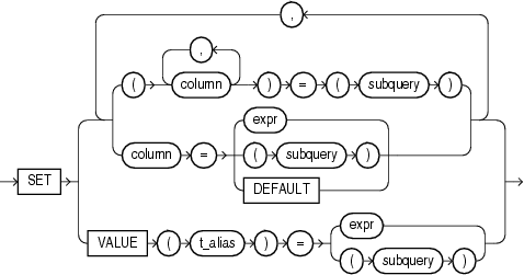

Description of update_set_clause.gif follows

update_set_clause
The update_set_clause lets you set column values.
column
Specify the name of a column of the object that is to be updated. If you omit a column of the table from the update_set_clause, then the value of that column remains unchanged.
If column refers to a LOB object attribute, then you must first initialize it with a value of empty or null. You cannot update it with a literal. Also, if you are updating a LOB value using some method other than a direct UPDATE SQL statement, then you must first lock the row containing the LOB. See for_update_clause for more information.
If column is part of the partitioning key of a partitioned table, then UPDATE will fail if you change a value in the column that would move the row to a different partition or subpartition, unless you enable row movement. Please refer to the row_movement_clause of CREATE TABLE or ALTER TABLE.
In addition, if column is part of the partitioning key of a list-partitioned table, then UPDATE will fail if you specify a value for the column that does not already exist in the partition_value list of one of the partitions.
subquery
Specify a subquery that returns exactly one row for each row updated.
  • If you specify only one column in the update_set_clause, then the subquery can return only one value.
  • If you specify multiple columns in the update_set_clause, then the subquery must return as many values as you have specified columns.
  • If the subquery returns no rows, then the column is assigned a null.
  • If this subquery refers to remote objects, then the UPDATE operation can run in parallel as long as the reference does not loop back to an object on the local database. However, if the subquery in the DML_table_expression_clause refers to any remote objects, then the UPDATE operation will run serially without notification.
You can use the flashback_query_clause within the subquery to update table with past data. Please refer to the flashback_query_clause of SELECT for more information on this clause.
See Also:
expr
Specify an expression that resolves to the new value assigned to the corresponding column.
DEFAULT Specify DEFAULT to set the column to the value previously specified as the default value for the column. If no default value for the corresponding column has been specified, then the database sets the column to null.
Restriction on Updating to Default Values You cannot specify DEFAULT if you are updating a view.
VALUE Clause
The VALUE clause lets you specify the entire row of an object table.
Restriction on the VALUE clause You can specify this clause only for an object table.
If you insert string literals into a RAW column, then during subsequent queries, Oracle Database will perform a full table scan rather than using any index that might exist on the RAW column.
