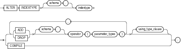

Syntax
alter_indextype::=
Description of alter_indextype.gif follows
(using_type_clause::=)

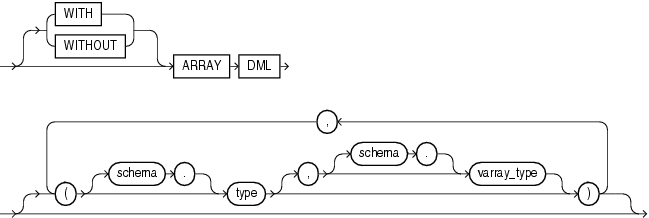

(array_DML_clause ::=)
Description of array_DML_clause.gif follows

ADD | DROP
Use the ADD or DROP clause to add or drop an operator.
No special privilege needed to drop.
  • For schema, specify the schema containing the operator. If you omit schema, then Oracle assumes the operator is in your own schema.
  • For operator, specify the name of the operator supported by the indextype.
    All the operators listed in this clause must be valid operators.
  • For parameter_type, list the types of parameters to the operator.

array_DML_clause
Use this clause to modify the indextype to support the array interface for the ODCIIndexInsert method.
type and varray_type If the datatype of the column to be indexed is a user-defined object type, then you must specify this clause to identify the varray varray_type that Oracle should use to hold column values of type. If the indextype supports a list of types, then you can specify a corresponding list of varray types. If you omit schema for either type or varray_type, then Oracle assumes the type is in your own schema.
If the datatype of the column to be indexed is a built-in system type, then any varray type specified for the indextype takes precedence over the ODCI types defined by the system.
