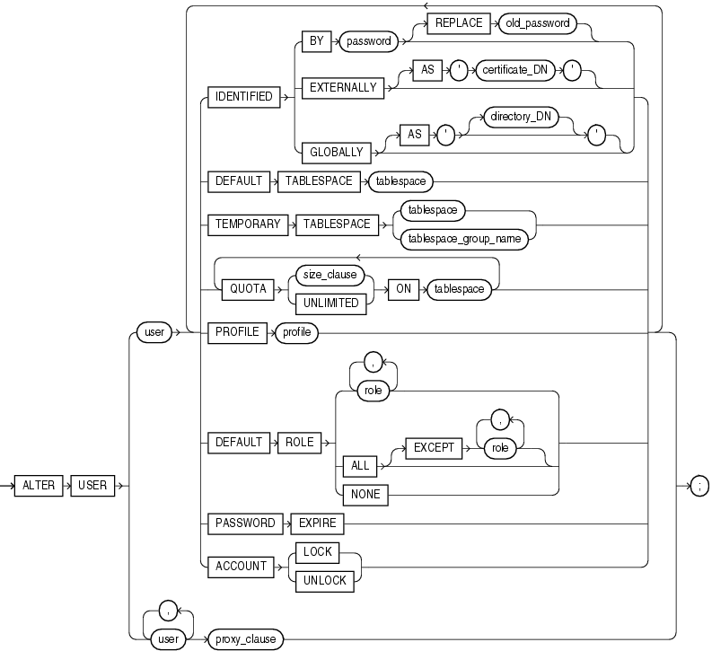

alter_user::=
Description of alter_user.gif follows

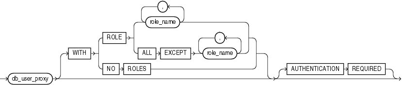

db_user_proxy::=
Description of db_user_proxy.gif follows

IDENTIFIED Clause
BY password  Specify BY password to specify a new password for the user.
Oracle Database expects a different timestamp for each resetting of a particular password. If you reset one password multiple times within one second (for example, by cycling through a set of passwords using a script), then the database may return an error message that the password cannot be reused. For this reason, Oracle recommends that you avoid using scripts to reset passwords.
You can omit the REPLACE clause if you are setting your own password for the first time or you have the ALTER USER system privilege and you are changing another user's password. However, unless you have the ALTER USER system privilege, you must always specify the REPLACE clause if a password complexity verification function has been enabled, either by running the UTLPWDMG.SQL script or by specifying such a function in the PASSWORD_VERIFY_FUNCTION parameter of a profile that has been assigned to the user.
Oracle Database does not check the old password, even if you provide it in the REPLACE clause, unless you are changing your own existing password. If such a check is important in other cases (for example, when a privileged user changes another user's password), then ensure that the password complexity verification function prohibits password changes in which the old password is null, or use the OCIPasswordChange() call instead of ALTER USER. For more information, see Oracle Call Interface Programmer's Guide.
See Also:
Oracle Database Administrator's Guide for information on the password complexity verification function
GLOBALLY Please refer to CREATE USER for more information on this clause.
You can change a user's access verification method from IDENTIFIED GLOBALLY to either IDENTIFIED BY password or IDENTIFIED EXTERNALLY. You can change a user's access verification method to IDENTIFIED GLOBALLY from one of the other methods only if all external roles granted explicitly to the user are revoked.
EXTERNALLY Please refer to CREATE USER for more information on this clause.
DEFAULT TABLESPACE Clause
Use this clause to assign or reassign a tablespace for the user's permanent segments. This clause overrides any default tablespace that has been specified for the database.
Restriction on Default Tablespaces You cannot specify a locally managed temporary tablespace, including an undo tablespace, or a dictionary-managed temporary tablespace, as a user's default tablespace.
TEMPORARY TABLESPACE Clause
Use this clause to assign or reassign a tablespace or tablespace group for the user's temporary segments.
  • Specify tablespace to indicate the user's temporary tablespace.
  • Specify tablespace_group_name to indicate that the user can save temporary segments in any tablespace in the tablespace group specified by tablespace_group_name.
Restriction on User Temporary Tablespace Any individual tablespace you assign or reassign as the user's temporary tablespace must be a temporary tablespace and must have a standard block size.
DEFAULT ROLE Clause
Specify the roles granted by default to the user at logon. This clause can contain only roles that have been granted directly to the user with a GRANT statement. You cannot use the DEFAULT ROLE clause to enable:
  • Roles not granted to the user
  • Roles granted through other roles
  • Roles managed by an external service (such as the operating system), or by the Oracle Internet Directory
Oracle Database enables default roles at logon without requiring the user to specify their passwords or otherwise be authenticated. If you have granted an application role to the user, you should use the DEFAULT ROLE ALL EXCEPT role clause to ensure that, in subsequent logons by the user, the role will not be enabled except by applications using the authorized package.

WITH ROLE WITH ROLE role_name permits the proxy to connect as the specified user and to activate only the roles that are specified by role_name.
WITH ROLE ALL EXCEPT WITH ROLE ALL EXCEPT role_name permits the proxy to connect as the specified user and to activate all roles associated with that user except those specified for role_name.
WITH NO ROLES WITH NO ROLES permits the proxy to connect as the specified user, but prohibits the proxy from activating any of that user's roles after connecting.
If you do not specify any of these WITH clauses, then Oracle Database activates all roles granted to the specified user automatically.
AUTHENTICATION REQUIRED Clause  Specify AUTHENTICATION REQUIRED to ensure that authentication credentials for the user must be presented when the user is authenticated through the specified proxy. The credential is a password.
AUTHENTICATED USING  This clause is no longer needed. It has been deprecated and is ignored if you use it in your code. Please specify the proxy_clause either with or without the AUTHENTICATION REQUIRED clause.
