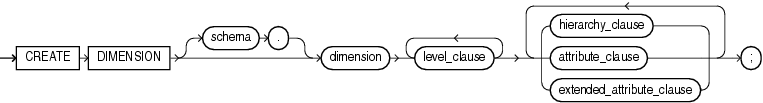

create_dimension::=
Description of create_dimension.gif follows
