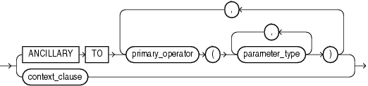

implementation_clause
Use this clause to describe the implementation of the binding.
ANCILLARY TO Clause
Use the ANCILLARY TO clause to indicate that the operator binding is ancillary to the specified primary operator binding (primary_operator). If you specify this clause, then do not specify a previous binding with just one number parameter.

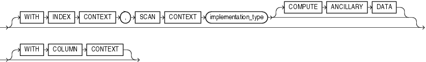

context_clause
Use the context_clause to describe the functional implementation of a binding that is not ancillary to a primary operator binding.
WITH INDEX CONTEXT, SCAN CONTEXT Use this clause to indicate that the functional evaluation of the operator uses the index and a scan context that is specified by the implementation type.
COMPUTE ANCILLARY DATA Specify COMPUTE ANCILLARY DATA to indicate that the operator binding computes ancillary data.
WITH COLUMN CONTEXT Specify WITH COLUMN CONTEXT to indicate that Oracle Database should pass the column information to the functional implementation for the operator.
If you specify this clause, then the signature of the function implemented must include one extra ODCIFuncCallInfo structure.
