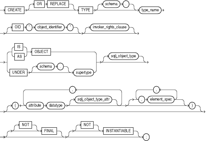

create_object_type::=
Description of create_object_type.gif follows
(invoker_rights_clause::=, element_spec::=)

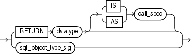

return_clause::=
Description of return_clause.gif follows
(call_spec::=, sqlj_object_type_sig::=)

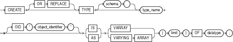

create_varray_type::=
Description of create_varray_type.gif follows

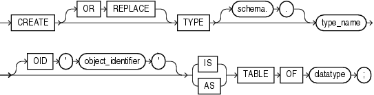

create_nested_table_type::=
Description of create_nested_table_type.gif follows

create_object_type
Use the create_object_type clause to create a user-defined object type. The variables that form the data structure are called attributes. The member subprograms that define the behavior of the object are called methods. The keywords AS OBJECT are required when creating an object type.
OID Clause
The OID clause is useful for establishing type equivalence of identical objects in more than one database. Please refer to Oracle Data Cartridge Developer's Guide for information on this clause.

return_clause The first form of the return_clause is valid only for a function. The syntax shown is an abbreviated form.
See Also:
sqlj_object_type_sig Use this form of the return_clause if you intend to create SQLJ object type functions or procedures.
  • If you are mapping a Java class to a SQLJ object type and you specify EXTERNAL NAME, then the value of the Java method returned must be compatible with the SQL returned value, and the Java method must be public. Also, the method signature (method name plus parameter types) must be unique within the type hierarchy.
  • If you specify EXTERNAL VARIABLE NAME, then the type of the Java static field must be compatible with the return type.

create_varray_type
The create_varray_type lets you create the type as an ordered set of elements, each of which has the same datatype. You must specify a name and a maximum limit of one or more. The array limit must be an integer literal. Oracle Database does not support anonymous varrays.
The type name for the objects contained in the varray must be one of the following:
  • A built-in datatype
  • A REF
  • An object type
Restrictions on Varray Types You can create a VARRAY type of XMLType or of a LOB type for procedural purposes, for example, in PL/SQL or in view queries. However, database storage of such a varray is not supported, so you cannot create an object table or an object type column of such a varray type.
The create_nested_table_type lets you create a named nested table of type datatype.
  • If datatype is an object type, then the nested table type describes a table whose columns match the name and attributes of the object type.
  • If datatype is a scalar type, then the nested table type describes a table with a single, scalar type column called COLUMN_VALUE.
Restriction on Nested Table Types You cannot specify NCLOB for datatype. However, you can specify CLOB or BLOB.
