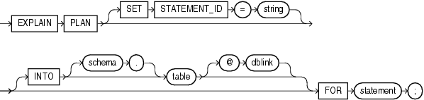

Syntax
explain_plan::=
Description of explain_plan.gif follows

SET STATEMENT_ID Clause
Specify a value for the STATEMENT_ID column for the rows of the execution plan in the output table. You can then use this value to identify these rows among others in the output table. Be sure to specify a STATEMENT_ID value if your output table contains rows from many execution plans. If you omit this clause, then the STATEMENT_ID value defaults to null.
INTO table Clause
Specify the name of the output table, and optionally its schema and database. This table must exist before you use the EXPLAIN PLAN statement.
If you omit schema, then the database assumes the table is in your own schema.
The dblink can be a complete or partial name of a database link to a remote Oracle Database where the output table is located. You can specify a remote output table only if you are using Oracle Database distributed functionality. If you omit dblink, then the database assumes the table is on your local database. See "Referring to Objects in Remote Databases" for information on referring to database links.
If you omit INTO altogether, then the database assumes an output table named PLAN_TABLE in your own schema on your local database.
FOR statement Clause
Specify a SELECT, INSERT, UPDATE, DELETE, CREATE TABLE, CREATE INDEX, or ALTER INDEX ... REBUILD statement for which the execution plan is generated.
