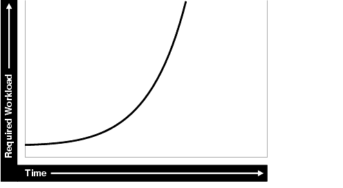

Figure 2-1 illustrates the classic workload growth curve, with demand growing at an increasing rate. Applications must scale with the increase of workload and also when additional hardware is added to support increasing demand. Design errors can cause the implementation to reach its maximum, regardless of additional hardware resources or re-design efforts.
Figure 2-1 Workload Growth Curve
Description of Figure 2-1 follows
Description of "Figure 2-1 Workload Growth Curve"
