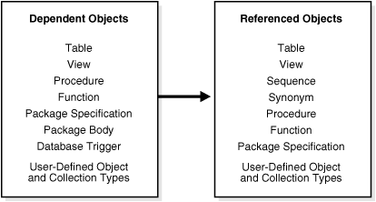

Introduction to Dependency Issues
Some types of schema objects can reference other objects as part of their definition. For example, a view is defined by a query that references tables or other views. A procedure's body can include SQL statements that reference other objects of a database. An object that references another object as part of its definition is called a dependent object, while the object being referenced is a referenced object. Figure 6-1 illustrates the different types of dependent and referenced objects:
Figure 6-1 Types of Possible Dependent and Referenced Schema Objects
Description of Figure 6-1 follows
Description of "Figure 6-1 Types of Possible Dependent and Referenced Schema Objects"
If you alter the definition of a referenced object, dependent objects may or may not continue to function without error, depending on the type of alteration. For example, if you drop a table, no view based on the dropped table is usable.
Oracle automatically records dependencies among objects to alleviate the complex job of dependency management for the database administrator and users. For example, if you alter a table on which several stored procedures depend, Oracle automatically recompiles the dependent procedures the next time the procedures are referenced (run or compiled against).

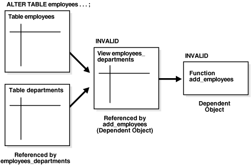

Oracle automatically tracks specific changes in the database and records the appropriate status for related objects in the data dictionary.
Status recording is a recursive process. Any change in the status of a referenced object changes the status not only for directly dependent objects, but also for indirectly dependent objects.
For example, consider a stored procedure that directly references a view. In effect, the stored procedure indirectly references the base tables of that view. Therefore, if you alter a base table, the view is invalidated, which then invalidates the stored procedure. Figure 6-2 illustrates indirect dependencies:
Figure 6-2 Indirect Dependencies
Description of Figure 6-2 follows
Description of "Figure 6-2 Indirect Dependencies"
