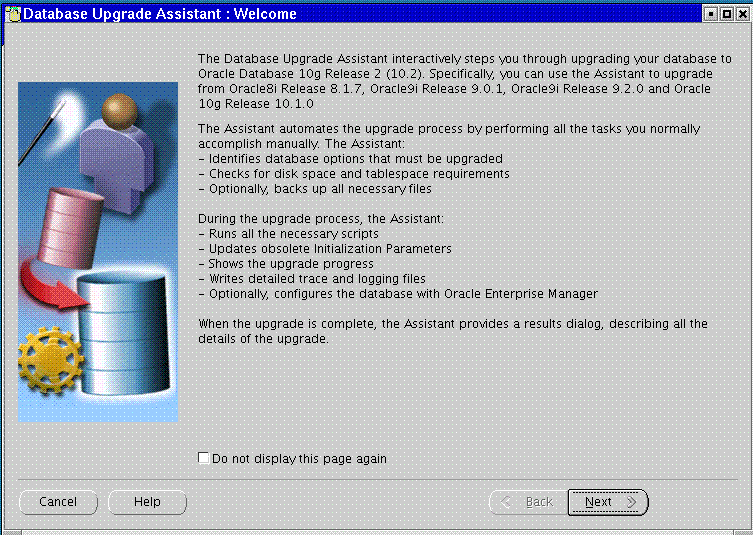

3 Upgrading to the New Oracle Database 10g Release
This chapter guides you through the process of upgrading a database to the new Oracle Database 10g release. This chapter covers the following topics:

When using the Database Upgrade Assistant or when performing a manual upgrade, you cannot migrate data in a database on one operating system to a database on another operating system. For example, you cannot migrate data in an Oracle9i database on Solaris to an Oracle Database 10g database on Windows 2000 using the Database Upgrade Assistant.
If you need to migrate Oracle Database to a different operating system, the best practice is to follow these steps:
  1. Upgrade to the newest Oracle Database 10g release on the current operating system platform following the instructions in this book.
  2. Use the Oracle Database 10g cross-platform transportable tablespace feature or the Oracle Data Pump Export and Import utilities to migrate the upgraded database to the different operating system.

When the Database Upgrade Assistant starts, its Welcome screen appears. Figure 3-1 shows the Welcome screen of the Database Upgrade Assistant. Before the upgrade, the DBUA performs the following steps:
  • Check for any invalid user accounts or roles
  • Check for any invalid datatypes or invalid objects
  • Check for any desupported character sets
  • Check for adequate resources, including rollback segments, tablespaces, and free disk space
  • Check for any missing SQL scripts needed for the upgrade
  • Optionally, DBUA backs up all necessary files
The DBUA does not begin the upgrade until all of these pre-upgrade steps are completed.
During the upgrade, the DBUA automatically modifies or creates new required tablespaces and invokes the appropriate upgrade scripts.
While the upgrade is running, the DBUA shows the upgrade progress for each component. The DBUA writes detailed trace and log files and produces a complete HTML report for later reference. To enhance security, the DBUA automatically locks new user accounts in the upgraded database. The DBUA then proceeds to create new configuration files (parameter and listener files) in the new Oracle home.
If you need detailed instructions on using the DBUA graphical user interface, see Appendix D, "Using the Database Upgrade Assistant".
Figure 3-1 Welcome Screen of the Database Upgrade Assistant
Description of Figure 3-1 follows
Description of "Figure 3-1 Welcome Screen of the Database Upgrade Assistant"
