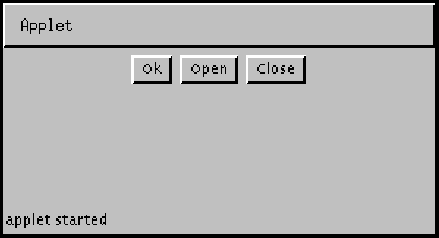

For example, the following picture shows an applet using the flow layout manager (its default layout manager) to position three buttons:
Graphic of Layout for Three Buttons
Here is the code for this applet:
 import java.awt.*;
 import java.applet.Applet;
 public class myButtons extends Applet {
     Button button1, button2, button3;
     public void init() {
         button1 = new Button("Ok");
         button2 = new Button("Open");
         button3 = new Button("Close");
         add(button1);
         add(button2);
         add(button3);
A flow layout lets each component assume its natural (preferred) size.
