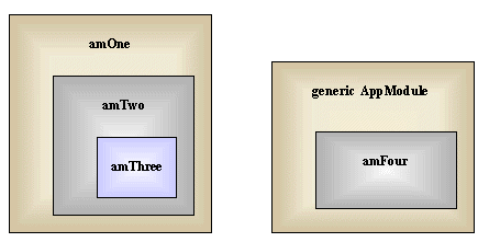

Application Modules can be nested. That is, an Application Module can (logically) contain one or more other Application Modules as well as View Objects. When Application Modules are nested, the outer-most (top-level) Application Module provides the transaction context for the others. Figure 2 shows two examples. In the first example, amTwo contains amThree, but it does not provide its transaction context because amOne is the outer-most Application Module. In the second example, the generic Application Module is outer-most, so it provides the transaction context for amFour.
The top-level Application Module defines a transaction context for groups of related queries and supports combining data changes from independent forms into the same transaction. By sharing an Application Module, forms can participate in the same transaction, and they can pass View Objects from the shared Application Module.
