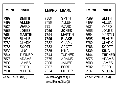

The following figure shows the effects of some of these methods. In the view at left, the range size is set to 5 (setRangeSize(5)), so the range contains the first 5 rows of the result set. Next, in the middle view, the start of the range is at row 4 (range start is 0-based, thus setRangeStart(3)) of the result set and the range size is set to 3, so the range contains rows 4 through 6 of the result set. Finally, in the view at right, the range window is scrolled forward 4 rows. The range size does not change, so the range contains rows 8 through 10 of the result set.

vo.setRangeSize(5); // vo.setRangeSize(-1) fetches all rows.
printRows(vo.getAllRowsInRange(), vo.getRangeStart()); // Gets rows 0 - 4.
    // Range window starts at row 5. Row numbers start with 0.
vo.setRangeStart(4);
vo.setRangeSize(3); // Change range size.
printRows(vo.getAllRowsInRange(), vo.getRangeStart()); // Gets rows 4 - 6.
    // Range window scrolls 2 rows. Range size stays the same.
vo.scrollRange(-2); // Positive scrolls forward, negative scrolls back.
printRows(vo.getAllRowsInRange(), vo.getRangeStart()); // Gets rows 2 - 4.
