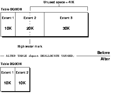

A table consists of three extents. The first extent is 10K, the second is 20K, and the third is 30K. The high water mark is in the middle of the second extent, and there is 40K of unused space. Figure 14-3 illustrates the effect of issuing the following statement:
All unused space is deallocated, leaving table dquon with two remaining extents. The third extent disappears, and the second extent size is 10K.
Figure 14-3 Deallocating All Unused Space
Text description of admin015.gif follows

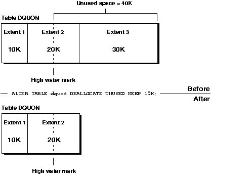

But, if you had issued the following statement specifying the KEEP keyword, then 10K above the high water mark would be kept, and the rest of the unused space would be deallocated from dquon.
In effect, the third extent is deallocated and the second extent remains intact.
Figure 14-4 illustrates this situation.
Figure 14-4 Deallocating Unused Space, KEEP 10K
