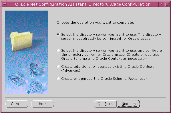

  2. Select Directory Service Usage Configuration, and then click Next.
    The Directory Usage Configuration page appears.
    Text description of dircongi.gif follows.
    The Directory Usage Configuration page options are described in Table 8-1.
    Table 8-1  Directory Usage Configuration Page in Oracle Net Configuration Assistant
    Option Description
    Select the directory server you want to use
    Select this option to enable this computer's Oracle home to use a directory server that is already configured for Oracle directory usage. This option is intended for clients to use directory naming.
    Once configuration is complete, the software in the Oracle home can then look up entries in the directory server. This option prompts you to:

    Note: If no Oracle schema or Oracle Context exists, then you cannot complete usage configuration using this option. You must first use the Select the directory server you want to use, and then configure the directory server for Oracle usage option to create the Oracle schema or Oracle Context.
    Select the directory server you want to use, and configure the directory server for Oracle usage.
    Select this option to configure a directory server for Oracle directory-enabled features and enable the Oracle home to use that directory. This option is intended for administrators to first configure the directory for Oracle features.
    • Select the type of directory server
    • Identify the location of the directory server
    • Select or enter a location in the directory server that contains an Oracle Context from which this computer can look up, create, or modify directory naming entries
    If an Oracle Context does not exist under the selected location, then Oracle Net Configuration Assistant prompts you to create one. Likewise, if the Oracle schema does not exist or is an older release, you are prompted to create or upgrade it. During the creation or upgrade of an Oracle schema or Oracle Context, you are prompted for directory administrator authentication credentials. To create an Oracle Context, the following must exist in the directory server:
    • Current release of the Oracle schema
    • A directory entry under which you want the Oracle Context to be created
    If the Oracle Context is created successfully, then the authenticated user is added to the following groups:
    • OracleContextAdmins (cn=OracleContextAdmins,cn=Groups,cn=OracleContext,...)
    • OracleDBCreators (cn=OracleDBCreators,cn=OracleContext,...)
    • OracleNetAdmins (cn=OracleNetAdmins,cn=OracleContext,...)
    See Also:
    Create additional or upgrade existing Oracle Context
    Select this option to create an additional Oracle Context in the directory, or upgrade the Oracle Context to the current release.
    During the creation or upgrade of an Oracle Context, you are prompted for directory administrator authentication credentials.
    Create or upgrade the Oracle Schema
    Select this option to create the Oracle schema in the directory, or upgrade the Oracle schema to the current release. During Oracle schema creation or upgrade, you are prompted for authentication credentials.
  3. Select the appropriate option, and then follow the prompts in the wizard and online help to complete directory server usage configuration.
