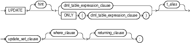

Use the UPDATE statement to change existing values in a table or in the base table of a view or the master table of a materialized view.
Additional Topics
For you to update values in a table, the table must be in your own schema or you must have the UPDATE object privilege on the table.
For you to update values in the base table of a view:
The UPDATE ANY TABLE system privilege also allows you to update values in any table or in the base table of any view.
You must also have the SELECT object privilege on the object you want to update if:
Description of update.gif follows
(DML_table_expression_clause::=, update_set_clause ::=, where_clause ::=, returning_clause ::=)
