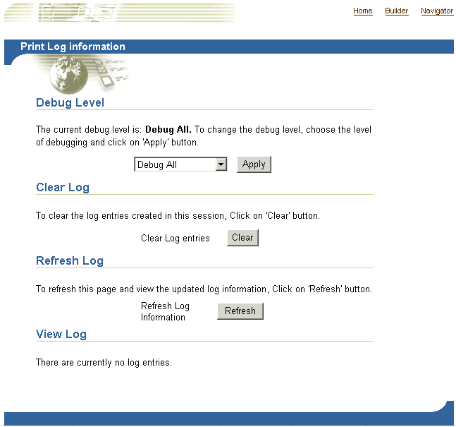

K.2.3.4 Oracle Application Server Portal Developer Kit
Oracle Application Server Portal Developer Kit (PDK) provides a framework for the construction of portlets and portlet providers in a variety of Web languages including Java, Web Services, XML, ASP, Perl, and PL/SQL. The PDK therefore includes JPDK.
The PDK provides a core logging mechanism, which is augmented by logging in specific developers kits. PDK logging is controlled through a Web-based user interface as shown in Figure K-2.
Figure K-2 PDK Logging Page
Description of Figure K-2  follows
Description of "Figure K-2 PDK Logging Page"
This PDK Logging Page can be found at:
http://<host>:<port>/portal/pls/<dad>/<schema>.wwpro_log.render
A sample URL is as follows:
http://myserver.myplace.com:3000/portal/pls/portal/PORTAL.wwpro_log.render
From this page you can apply the logging levels described in Table K-7.
Table K-7 PDK Log Levels
Level Detail
No debugging
No logging
PROHTTPJ
Provider framework logging
PROGRP
Provider logging
ADAPTER
Federated portal adapter logging
CACHE
Cache logging
FORCE
Internal to Oracle
INVAL
Invalidation logging
PROREG
Provider registration logging
PROLOGIN
Page metadata generation, login, and session initialization logging
PROPROV
Provider communication logging
PROPMR
Portlet metadata repository logging
PROHTTP
Web provider framework logging
All
All logging levels activated
PDK Log File Contents

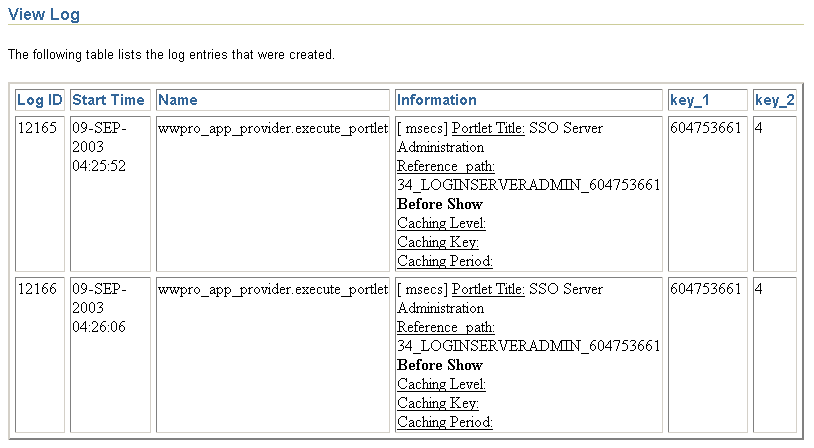

You can view PDK log entries from the same page used to configure PDK logs, as shown in Figure K-3.
Figure K-3 Log Entries in the PDK Logging Page
Description of Figure K-3  follows
Description of "Figure K-3 Log Entries in the PDK Logging Page"
