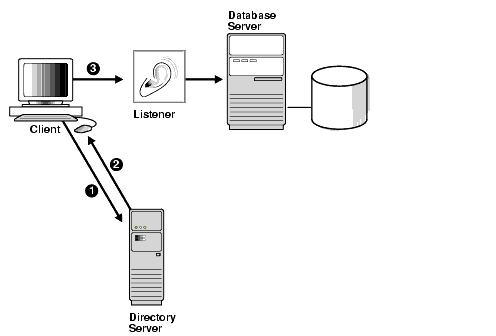

Directory Naming Overview
Oracle Net Services use a centralized directory server as one of the primary methods for storage of connect identifiers. Clients can use the connect identifiers in their connect string. The directory server resolves the connect identifier to a connect descriptor that is passed back to the client. This feature is called directory naming
Figure 3-1 shows a client resolving a connect identifier through a directory server.
  1. The client contacts the directory server to resolve a connect identifier to a connect descriptor.
  2. The directory server resolves the connect identifier and retrieves the connect descriptor for the client.
  3. The client sends the connection request to the listener, using the connect descriptor.
Figure 3-1 Client Using a Directory Server to Resolve a Connect Identifier
Description of net81059.gif is in surrounding text

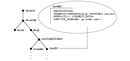

Net Service Alias Entries
In addition to database service and net service name entries, directory naming enables you to create net service alias entries. A net service alias is an alternative name for a net service name or database service. A net service alias entry does not have connect descriptor information. Instead, it only references the location of the entry for which it is an alias. When a client requests a directory lookup of a net service alias, the directory determines that the entry is a net service alias and completes the lookup as if it is the referenced entry. For example, in Figure 3-3, a net service alias of db1alias is created for a database service of db1. When db1alias is used to connect to a database service, as in CONNECT username/password@db1alias, it will actually resolve to and use the connect descriptor information for db1.
Figure 3-3 Net Service Alias db1alias in a Directory Server
Description of net81132.gif is in surrounding text
There are several uses for using net service aliases. As shown in Figure 3-3, a net service alias can be useful as a way for clients to refer to a net service name by another name. Another use is to have a net service alias in one Oracle Context for a database service or net service name in a different Oracle Context. This enables a database service or net service name to be defined once in the directory server, but referred to by clients that use other Oracle Contexts.
In Figure 3-4, database service db1 resides in dc=jp,dc=acme,dc=com. A net service alias named db1 is created in dc=us,dc=acme,dc=com. This enables clients in both Japan and the United States to use the connect string CONNECT username/password@db1 as opposed to clients in the United States needing to specify CONNECT username/
Figure 3-4 Net Service Alias db1 in a Directory Server
Description of net81133.gif is in surrounding text
