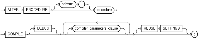

Description of alter_procedure.gif follows

Specify the schema containing the procedure. If you omit schema, then Oracle Database assumes the procedure is in your own schema.
Specify the name of the procedure to be recompiled.
Specify COMPILE to recompile the procedure. The COMPILE keyword is required. Oracle Database recompiles the procedure regardless of whether it is valid or invalid.
