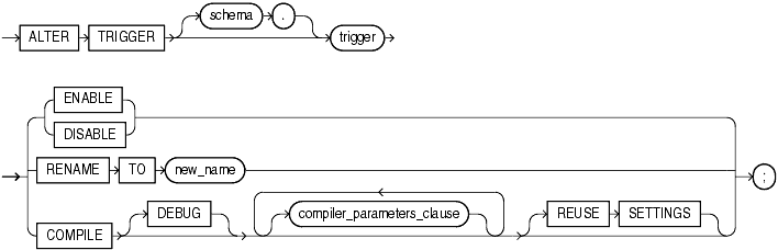

Use the ALTER TRIGGER statement to enable, disable, or compile a database trigger.
This statement does not change the declaration or definition of an existing trigger. To redeclare or redefine a trigger, use the CREATE TRIGGER statement with the OR REPLACE keywords.

Description of alter_trigger.gif follows

Specify the schema containing the trigger. If you omit schema, then Oracle Database assumes the trigger is in your own schema.
Specify the name of the trigger to be altered.
Specify ENABLE to enable the trigger. You can also use the ENABLE ALL TRIGGERS clause of ALTER TABLE to enable all triggers associated with a table. See ALTER TABLE .
Specify DISABLE to disable the trigger. You can also use the DISABLE ALL TRIGGERS clause of ALTER TABLE to disable all triggers associated with a table.
Specify RENAME TO new_name to rename the trigger. Oracle Database renames the trigger and leaves it in the same state it was in before being renamed.
When you rename a trigger, the database rebuilds the remembered source of the trigger in the USER_SOURCE, ALL_SOURCE, and DBA_SOURCE data dictionary views. As a result, comments and formatting may change in the TEXT column of those views even though the trigger source did not change.
Specify COMPILE to explicitly compile the trigger, whether it is valid or invalid. Explicit recompilation eliminates the need for implicit run-time recompilation and prevents associated run-time compilation errors and performance overhead.
Oracle Database first recompiles objects upon which the trigger depends, if any of these objects are invalid. If the database recompiles the trigger successfully, then the trigger becomes valid.
During recompilation, the database drops all persistent compiler switch settings, retrieves them again from the session, and stores them at the end of compilation. To avoid this process, specify the REUSE SETTINGS clause.
If recompiling the trigger results in compilation errors, then the database returns an error and the trigger remains invalid. You can see the associated compiler error messages with the SQL*Plus command SHOW ERRORS.
Specify DEBUG to instruct the PL/SQL compiler to generate and store the code for use by the PL/SQL debugger. Specifying this clause has the same effect as specifying PLSQL_DEBUG = TRUE in the compiler_parameters_clause.
