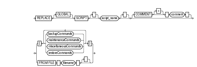

Text description of replaceScript.gif follows
To replace an existing script stored in the recovery catalog. If the script does not exist, then REPLACE SCRIPT creates it.

Keywords and Parameters
Syntax Element Description

COMMENT ='comment'
An explanatory comment, used in the output of LIST SCRIPT NAMES..
FROM FILE 'filename'
The new contents of the script are to be read from this file. The first line of the file must begin with a "{", the last line must contain a "}" and the commands must be valid within a RUN block.
{ backupCommands
| maintenanceCommands
| miscellaneousCommands
| restoreCommands
Commands valid in a stored script. These are the same commands supported within a RUN block. See "RUN" for more details about backupCommands, restoreCommands, maintenanceCommands, and miscellaneousCommands.
