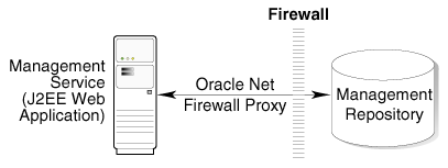

Firewalls Between the Management Service and the Management Repository
Secure connections between the Management Service and the Management Repository are performed using features of Oracle Advanced Security. As a result, if the Management Service and the Management Repository are separated by a firewall, you must configure the firewall to allow Oracle Net firewall proxy access.
See Also:
"Configuring Secure Sockets Layer Authentication" in the Oracle Database Advanced Security Administrator's Guide
Figure 19-8 shows a typical configuration of a firewall between the Management Service and the Management Repository.
Figure 19-8 Firewall Between the Management Service and the Management Repository
Description of Figure 19-8 follows
Description of "Figure 19-8 Firewall Between the Management Service and the Management Repository"

Description of "Figure 19-10 Firewall Between Grid Control and Managed Database Target"
