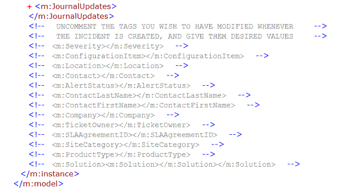

In most cases, when you modify the ticket template, you might only be changing the mappings. Example 4–1 illustrates this concept.
Example 4-1 Adding an existing data element exposed in the ServiceCenter Incident Management WSDL
  1. Select an out-of-the-box template (.XSL) and make a copy. For example, copy ServiceCenter_Default_Incident_AutoClose.XSL to ServiceCenter_Main_Incident_AutoClose.XSL.
  2. Modify the new XSL document to reflect the change. This example makes a simple change to set the default company to a fixed 'value' of 'AJAX'. Open the newly-copied XSL file in edit mode as shown in Figure 4–1.
    Figure 4-1 Modifying HP ServiceCenter Template
    Surrounding text describes Figure 4-1 .
    The XSL has two primary branches: Create Incident and Update Incident. This example only modifies the first branch.
  3. Navigate to the code in the incident create block as shown above. Uncomment the Company element as shown below and add the fixed text of AJAX.
    <m:Company>AJAX</m:Company>
    This instructs the connector framework to supply the value of AJAX in the ServiceCenter field value of Company.
  4. Save the file and register the template as described in Section 3.4.1, "Registering Ticket Templates".
  5. The template is now ready to use in notification rules or as a template for manual ticket creation. When used, it behaves the same as the out-of-the-box template copied, except when a ServiceCenter incident is created, the incident company will be AJAX. Of course, AJAX must be a valid ServiceCenter company or the request will fail.
