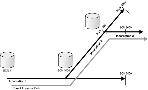

An incarnation number is used to uniquely tag and identify a stream of redo. Figure 13-1 illustrates a database that goes through several incarnations, each with a different incarnation number.
Figure 13-1 Database Incarnation History
Diagram showing the incarnation history of a database
Description of "Figure 13-1 Database Incarnation History"
Incarnation 1 of the database starts at SCN 1 and continues through SCN 1000 to SCN 2000. Suppose that at SCN 2000 in incarnation 1, you perform a point-in-time recovery back to SCN 1000, and then open the database with the RESETLOGS option. Incarnation 2 now begins at SCN 1000 and continues to SCN 3000. In this example, incarnation 1 is the parent of incarnation 2.
Suppose that at SCN 3000 in incarnation 2, you perform a point-in-time recovery to SCN 2000 and open the database with the RESETLOGS option. In this case, incarnation 2 is the parent of incarnation 3. Incarnation 1 is an ancestor of incarnation 3.
When DBPITR or Flashback Database has occurred in database, an SCN can refer to more than one point in time, depending on which incarnation is current. For example, SCN 1500 in Figure 13-1 could refer to an SCN in incarnation 1 or 2.
You can use the RESET DATABASE TO INCARNATION command to specify that SCNs are to be interpreted in the frame of reference of a specific database incarnation. The RESET DATABASE TO INCARNATION command is required when you use FLASHBACK, RESTORE, or RECOVER to return to an SCN in a noncurrent database incarnation. However, RMAN executes the RESET DATABASE TO INCARNATION command implicitly with Flashback, as explained in "Resetting the Database Incarnation in the Recovery Catalog".
Orphaned Backups
When a database goes through multiple incarnations, some backups can become orphaned backups. Orphaned backups are backups created during incarnations of the database that are not in the direct ancestral path.
Assume the scenario shown in Figure 13-1. If incarnation 3 is the current incarnation, then the following backups are orphaned:
  • All backups from incarnation 1 after SCN 1000
  • All backups from incarnation 2 after SCN 2000
In contrast, the following backups are not orphaned because they are in the direct ancestral path:
  • All backups from incarnation 1 prior to SCN 1000
  • All backups from incarnation 2 prior to SCN 2000
  • All backups from incarnation 3
You can use orphaned backups when you intend to restore the database to an SCN not in the direct ancestral path. RMAN can restore backups from parent and ancestor incarnations and recover to the current time, even across OPEN RESETLOGS operations, as long as a continuous path of archived logs exists from the earliest backups to the point to which you want to recover. If you restore a control file from an incarnation in which the changes represented in the backups had not been abandoned, then RMAN can also restore and recover orphaned backups.
