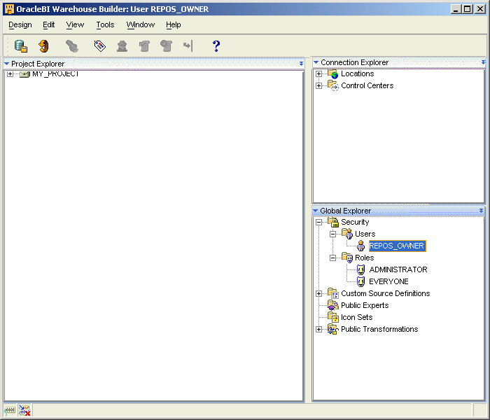

Log in to the Warehouse Builder Design Center as the design repository owner and Warehouse Builder displays the Global Explorer as shown in Figure 7-1, "Global Explorer" in the lower right corner of the Design Center.
Figure 7-1 Global Explorer
This illustration is described in the surrounding text.
Description of "Figure 7-1 Global Explorer"
Under the security node, notice there are two predefined roles, ADMINISTRATOR and EVERYONE. The one predefined user is the design repository owner, REPOS_OWNER in this example, which is assigned the ADMINISTRATOR role by default.
To perform actions under the Security node, select an object and right-click to view all of the possible operations. Or select an object and select Edit from the menu bar. For a complete list of all the tasks administrators can perform, see "Administrator Role".

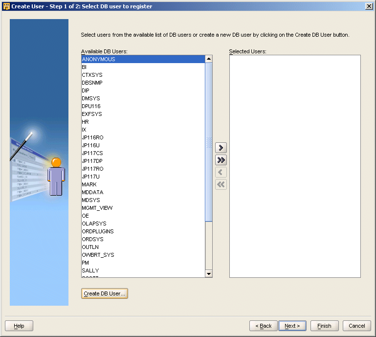

All Warehouse Builder users must also be Oracle Database users.
Use a wizard within Warehouse Builder to either register existing database users or create new database users and then register them in Warehouse Builder.
Note: Although, you are able to create users in SQL Plus, it is not advisable. Creating users through the Warehouse Builder interface ensures that users are assigned the necessary roles and privileges.
To start the registration wizard, go to the Security node in the Global Explorer, right-click Users and select New. Follow the prompts in the wizard as described in "Selecting Existing or Creating New Database Users".
The left panel in Figure 7-2 lists the Oracle Database users defined for the design repository. Either select existing database users from the list or define and register a new user by clicking on Create DB User... located in the lower left corner.
When selecting from the list, you can select one or more database users. Notice that, for security reasons, you cannot register database administrator users such as SYS. The database default role settings must not be set to ALL. You can change the database default role settings from within the wizard as described in "Changing Database Default Roles".
Figure 7-2 Creating and Registering Users
Description of "Figure 7-2 Creating and Registering Users"

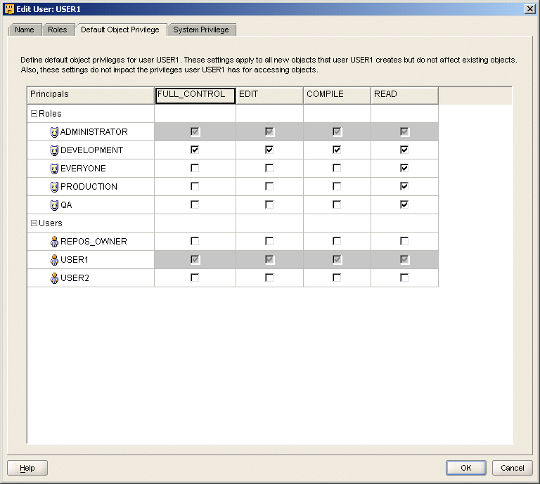

Default Object Privilege
Default object privileges define the access other users and roles have to objects the selected user creates. These privileges do not impact the privileges the user has for accessing objects that others create.
For example, Figure 7-3, "Default Object Privilege Settings for USER1" shows that for all objects that USER1 creates, USER1 and the ADMINISTRATOR and DEVELOPMENT roles have full access while the EVERYONE, PRODUCTION, and QA roles are restricted to read only.
If you are familiar with UNIX operating system security, then note that the default object privilege behaves similarly to the UMASK command. When you edit the default object privilege, the change only effects objects the user subsequently creates. There is no effect on previously created objects. Therefore, if you set default object privileges at the onset, then little or no additional object-level security setup is necessary.
To define the privileges other users have to objects the selected user creates, check the appropriate box for each role or user. You can grant the following privileges: FULL CONTROL, EDIT, COMPILE, and READ. All the privileges are additive. If you select COMPILE, then you apply both the compile and read privileges.
Figure 7-3 Default Object Privilege Settings for USER1
Description of "Figure 7-3 Default Object Privilege Settings for USER1"
Figure 7-3, "Default Object Privilege Settings for USER1" shows access granted to roles. You can also grant access to individual users. However, when you grant access to a role, the privilege is also extended to all users in that role. Therefore, in Figure 7-3, even though USER2 is not specifically granted access, USER2 has read access through the EVERYONE role. Furthermore, if USER2 is a member of the DEVELOPMENT role, then that user has full control and access.
Important:
By default, when you create a new user, the EVERYONE role has full control on all objects. To enable metadata security, be sure to edit all user profiles and restrict the access the EVERYONE role has to objects each user creates.
