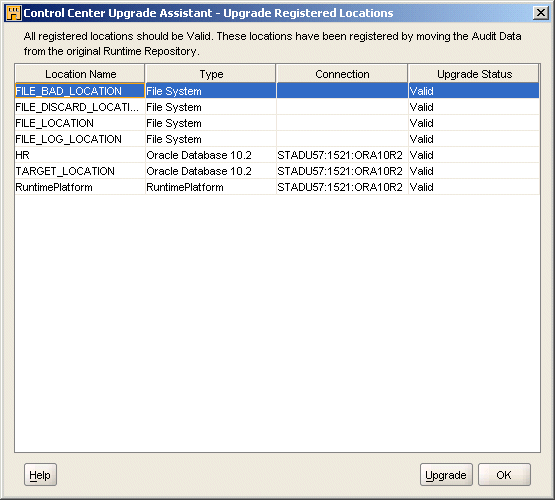

Upgrade
The assistant lists the locations registered in the new control center and displays whether they are valid or not. Figure 3-2 displays the Upgrade Registered Locations dialog.
Figure 3-2 Upgrade Registered Locations Dialog
This figure is described in the surrounding text.
Description of "Figure 3-2 Upgrade Registered Locations Dialog"

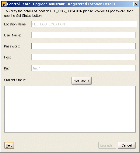

Upgrade Operation: Location Details
Select a location and use this button to check and fix locations for possible errors. Ensure that all locations are valid before proceeding. Figure 3-3 displays the Registered Locations Details dialog.
Figure 3-3 Registered Locations Details Dialog
Description of "Figure 3-3 Registered Locations Details Dialog"
This dialog box displays the registration details of the currently selected location. Select Get Status to evaluate its status and view the results of various tests.
For each location, the assistant checks that the password is valid and that it is the same as the registered password. The assistant verifies that the version registered for the location is the same as the actual version. If the assistant detects any errors, then you can select Upgrade to correct the errors.
