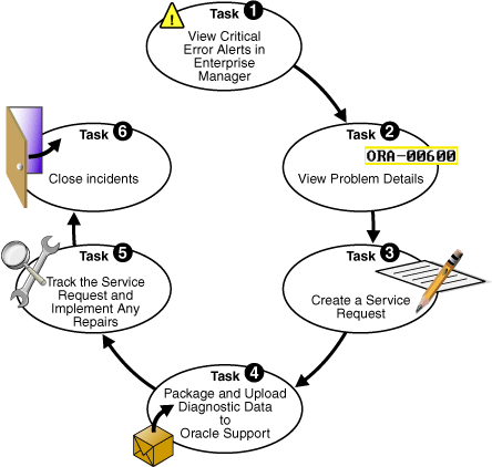

Figure 11-1 illustrates the basic tasks that you complete when encountering a problem.
Figure 11-1 Workflow for Investigating, Reporting, and Resolving a Problem
Description of Figure 11-1 follows
Description of "Figure 11-1 Workflow for Investigating, Reporting, and Resolving a Problem"
The following are task descriptions. Subsequent sections provide details for each task.
Task 1 – View Critical Error Alerts in Enterprise Manager

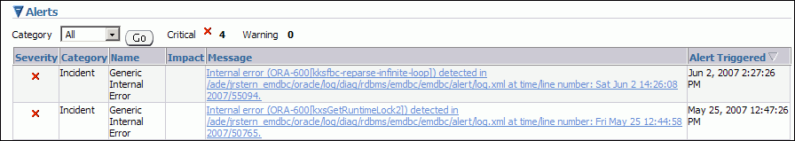

  2. In the Alerts section, examine the table of alerts.
    Critical error alerts are indicated by an X in the Severity column, and the text "Incident" in the Category column.
    You may have to click the hide/show arrowhead icon next to the Alerts heading to display the alerts table.
    Description of critical_alert_home_jrs.gif follows

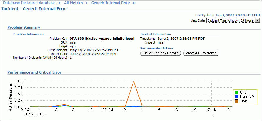

  3. (Optional) In the Category list, select Incident to view alerts of type Incident only.
  4. In the Message column, click the message of the critical error alert that you want investigate.
    An Incident detail or Data Failure page appears for the type of incident you selected. For example, if you clicked a message about an ORA-600 error, the Incident - Generic Internal Error page appears.
    This page displays:
    • Problem information, including the number of incidents for the problem
    • A Performance and Critical Error graphical timeline for the 24-hour time period in which the critical error occurred
    • Alert details, including severity, timestamp, and message
    • Controls that enable you to clear the alert or record a comment about it
    Description of critical_alert_perf.gif follows
  5. Review the Performance and Critical Error graphical timeline, and note any time correlation between performance issues and the critical error. Optionally clear the alert or leave a comment about it.

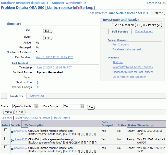

  1. On the Incident detail or Data Failure page, click View Problem Details.
    The Problem Details page appears, showing the Incidents subpage.
  2. (Optional) To view incident details, in the Incidents subpage, select an incident, and then click View.
    The Incident Details page appears, showing the Dump Files subpage.
  3. (Optional) On the Incident Details page, click Checker Findings to view the Checker Findings subpage.
    This page displays findings from any health checks that were automatically run when the critical error was detected.

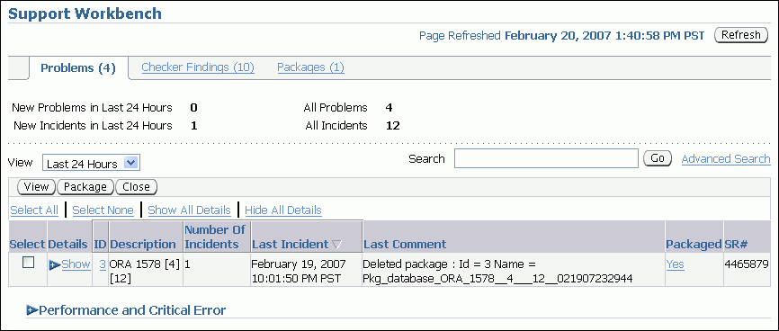

    The Support Workbench home page appears, showing the Problems subpage. By default the problems from the last 24 hours are displayed.
    Description of support_workbench_home.gif follows
  4. To view all problems, select All from the View list.
  5. (Optional) If the Performance and Critical Error section is hidden, click the Show/Hide icon adjacent to the section heading to show the section.
    This section enables you to view any correlation between performance changes for your database and incident occurrences.
  6. (Optional) Under the Details column, click Show to display a list of all incidents for a problem, and then click an incident ID to display the Incident Details page.
