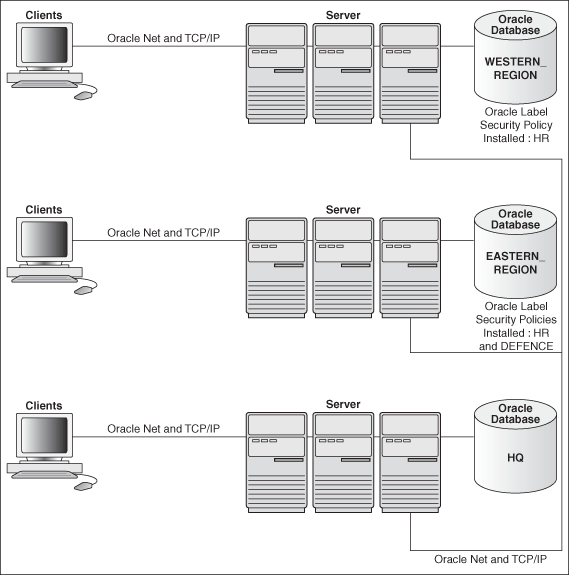

A network configuration that supports distributed databases can include multiple Oracle Database servers, or other database servers, running on the same or different operating systems. Each cooperative server in a distributed system communicates with other clients and servers over a network.
Figure 13-1, "Using Oracle Label Security with a Distributed Database" illustrates a distributed database that includes clients and servers with and without Oracle Label Security. As described in this chapter, if you establish database links from the WESTERN_REGION database to the EASTERN_REGION database, then you can access data if your userid on EASTERN_REGION is authorized to see it, even if locally (on WESTERN_REGION) you do not have this access.
Figure 13-1 Using Oracle Label Security with a Distributed Database
Description of Figure 13-1 follows
Description of "Figure 13-1 Using Oracle Label Security with a Distributed Database"
