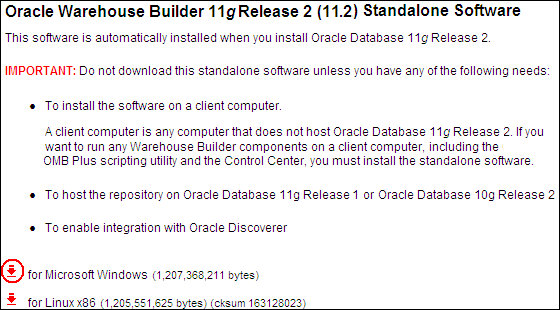

  4. Under the Standalone Software download, click the down arrow beside the platform of your choice to download the zip file that contains Oracle Warehouse Builder.
    On Windows: choose the Microsoft Windows option.
    On Linux: choose the Linux x86 option.
    Description of download_04.gif follows
    Oracle Warehouse Builder installation requires 2 GB of disk space. This includes 1.59 GB of drive space for Oracle Warehouse Builder installation and 256 MB for Oracle Inventory.

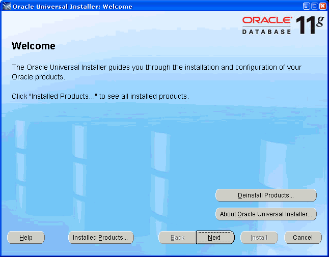

  3. On the Welcome screen, click Next.
    Description of install_02.gif follows

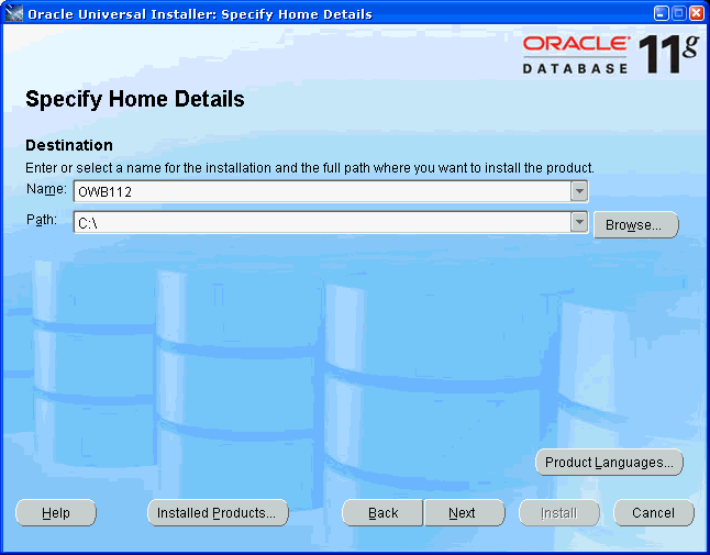

  4. On the Specify Home Details screen, specify a new Oracle home:
    • Enter the Oracle home Name, for example, OWB112.
    • Enter or browse to Path C:\.
    • Click Next.
    Description of install_03.gif follows
    Tip:
    To ensure a successful installation:
    • Do not use an existing Oracle home.
    • Do not use any spaces in the directory path.

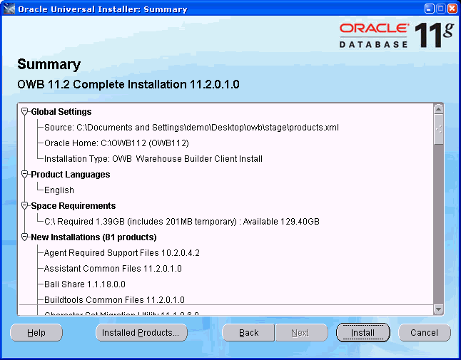

  6. On the Summary screen, click Install.
    Description of install_04.gif follows

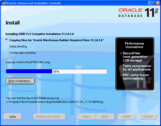

  7. The Install screen shows progress during the installation process.
    Description of install_05.gif follows

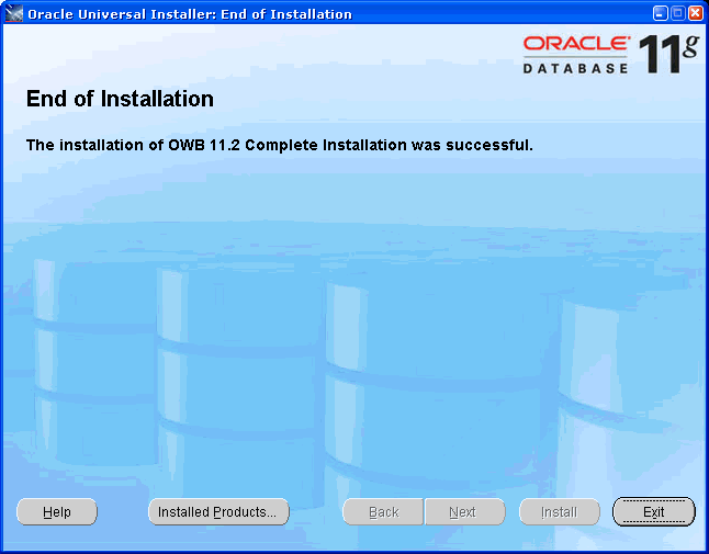

  8. At the End of Installation screen, click Exit. The Exit message appears asking if you really want to exit.
    Description of install_06.gif follows
  9. In the Exit message, click Yes.
    Description of install_07.gif follows
