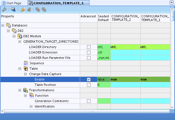

Editing Configuration Templates
To edit the configuration values in a template, use the Configuration Template Editor, that enables to set the configuration properties of objects to Advanced, and to override the existing configuration defaults.
The configuration template editor can show the different templates side by side, to help compare and edit multiple templates.
To edit a configuration template:
  1. In the Globals Navigator, under Configuration Templates, click the Manage Configuration Template Columns icon.
    Description of edit_config_temp_01.gif follows
  2. In the Select Templates window, select the templates you want to edit.
    Click OK.
    Description of edit_config_temp_02.gif follows
  3. Click the Expand All icon.
    Description of edit_config_temp_03.gif follows
  4. Make changes to the side-by-side templates.
    Description of edit_config_temp_04.gif follows

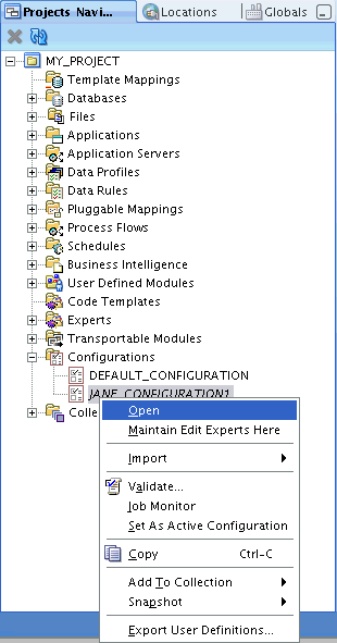

Activating Configurations
To activate a configuration:
  1. In the Project Navigator, select a project and expand its navigation tree.
  2. Expand the Configurations folder.
  3. Select a configuration.
  4. Right-click the selected configuration; from the menu, select Set As Active Configuration.
    Description of set_config_01.gif follows
All changes that you make to the configuration parameters of objects are saved in this configuration. If you switch to the previous configuration, these parameters show the settings of that configuration.
The Control Center service and Control Center Agent associated with this configuration are now set; they manage all future deployments or executions.
