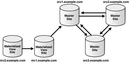

Chapters 2 - 6 work with the replication environment illustrated in Figure 2-1. You start to create this environment using the instructions in this chapter. Notice that mv2.example.com is a materialized view based on the mv1.example.com materialized view, creating a multitier materialized view environment. The arrows in Figure 2-1 represent database links.
Figure 2-1 Three Master Sites and Two Materialized View Sites
Description of Figure 2-1 follows
Description of "Figure 2-1 Three Master Sites and Two Materialized View Sites"

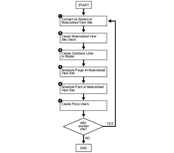

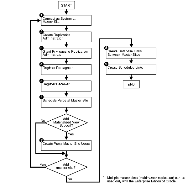

Follow the procedures identified in Figure 2-2 when you build a new master site or in Figure 2-3 when you build a new materialized view site.
Figure 2-2 Setting Up Master Sites
Description of Figure 2-2 follows
Description of "Figure 2-2 Setting Up Master Sites"

Creating Scheduled Links Between the Master Sites
Complete the following steps to create scheduled links between the master sites.
Step 1   Create database links between master sites.
The database links provide the necessary distributed mechanisms to allow the different replication sites to replicate data among themselves. Before you create any private database links, you must create the public database links that each private database link will use. You then must create a database link between all replication administrators at each of the master sites that you have set up.
See Also:
Oracle Database Administrator's Guide for more information about database links
CONNECT system@orc1.example.com
CREATE PUBLIC DATABASE LINK orc2.example.com USING 'orc2.example.com';
CREATE PUBLIC DATABASE LINK orc3.example.com USING 'orc3.example.com';
CONNECT repadmin@orc1.example.com
CREATE DATABASE LINK orc2.example.com CONNECT TO repadmin
 IDENTIFIED BY &password;
CREATE DATABASE LINK orc3.example.com CONNECT TO repadmin
CONNECT system@orc2.example.com
CREATE PUBLIC DATABASE LINK orc1.example.com USING 'orc1.example.com';
CONNECT repadmin@orc2.example.com
CREATE DATABASE LINK orc1.example.com CONNECT TO repadmin
CONNECT system@orc3.example.com
CONNECT repadmin@orc3.example.com

Setting Up Materialized View Sites
Figure 2-3 Setting Up Materialized View Sites
Description of Figure 2-3 follows
Description of "Figure 2-3 Setting Up Materialized View Sites"
Setting Up mv1.example.com
Complete the following steps to set up the mv1.example.com master materialized view site. mv1.example.com is a master materialized view site because mv2.example.com will be based on it. Before you set up the materialized sites, configure your network and Oracle Net so that all mv1.example.com can communicate with orc1.example.com and mv2.example.com can communicate with mv1.example.com.
If you are viewing this document online, then you can copy the text from the "BEGINNING OF SCRIPT" line after this note to the "END OF SCRIPT" line into a text editor and then edit the text to create a script for your environment.
/************************* BEGINNING OF SCRIPT ******************************
Step 1   Connect as SYSTEM at materialized view site at mv1.example.com.
You must connect as SYSTEM to the database that you want to set up as a materialized view site.
SET ECHO ON
SPOOL setup_mvs.out
CONNECT system@mv1.example.com
Step 2   Create materialized view site users at mv1.example.com.
Several users must be created at the materialized view site. These users are:
  • Materialized view administrator
  • Propagator
  • Refresher
  • Receiver (if the site will serve as a master materialized view site for other materialized views, as mv1.example.com is)
Complete the following tasks to create these users.
Create the materialized view administrator.
The materialized view administrator is responsible for creating and managing the materialized view site. Execute the GRANT_ADMIN_ANY_SCHEMA procedure to grant the materialized view administrator the appropriate privileges.
ACCEPT password PROMPT 'Enter password for user: ' HIDE
CREATE USER mviewadmin IDENTIFIED BY &password;
BEGIN
   DBMS_REPCAT_ADMIN.GRANT_ADMIN_ANY_SCHEMA (
      username => 'mviewadmin');
END;
GRANT COMMENT ANY TABLE TO mviewadmin;
GRANT LOCK ANY TABLE TO mviewadmin;
If you want your mviewadmin to be able to connect to the Advanced Replication interface in Oracle Enterprise Manager, then grant SELECT ANY DICTIONARY to mviewadmin:
GRANT SELECT ANY DICTIONARY TO mviewadmin;
Create the propagator.
The propagator is responsible for propagating the deferred transaction queue to the target master site.
CREATE USER propagator IDENTIFIED BY &password;
BEGIN
   DBMS_DEFER_SYS.REGISTER_PROPAGATOR (
      username => 'propagator');
END;
Create the refresher.
The refresher is responsible for "pulling" changes made to the replicated tables at the target master site to the materialized view site. This user refreshes one or more materialized views. If you want the mviewadmin user to be the refresher, then this step is not required.
CREATE USER refresher IDENTIFIED BY &password;
GRANT CREATE SESSION TO refresher;
GRANT ALTER ANY MATERIALIZED VIEW TO refresher;
Register the receiver.
The receiver receives the propagated deferred transactions sent by the propagator from materialized view sites. The receiver is necessary only if the site will function as a master materialized view site for other materialized view sites.
BEGIN
   DBMS_REPCAT_ADMIN.REGISTER_USER_REPGROUP (
      username => 'mviewadmin',
      privilege_type => 'receiver',
      list_of_gnames => NULL);
END;
Enter appropriate passwords for the administrative users.
See Also:
Oracle Database Security Guide for guidelines for choosing passwords
Step 3   Create database links to the master site.
Create a public database link.
Create the materialized view administrator database link.
You must create a database link from the materialized view administrator at the materialized view site to the proxy materialized view administrator at the master site.
CONNECT mviewadmin@mv1.example.com;
  CONNECT TO proxy_mviewadmin IDENTIFIED BY &password;
Create the propagator/receiver database link.
You must create a database link from the propagator at the materialized view site to the receiver at the master site. The receiver was defined when you created the master site.
CONNECT propagator@mv1.example.com
  CONNECT TO repadmin IDENTIFIED BY &password;
See Also:
Step 5
Step 4   Schedule purge at the mv1.example.com materialized view site.
To keep the size of the deferred transaction queue in check, purge successfully completed deferred transactions. The SCHEDULE_PURGE procedure automates the purge process for you. If your materialized view site only contains "read-only" materialized views, then you do not need to execute this procedure.
BEGIN
   DBMS_DEFER_SYS.SCHEDULE_PURGE (
   next_date => SYSDATE,
   interval => 'SYSDATE + 1/24',
   delay_seconds => 0,
   rollback_segment => '');
END;
Step 5   Schedule push at the mv1.example.com materialized view site (optional).
If the materialized view site has a constant connection to its master site, then you optionally can schedule push at the mv1.example.com materialized view site. If the materialized view site is disconnected from its master site for extended periods of time, then it is typically better not to schedule push and refresh on demand, which pushes changes to the master site.
The SCHEDULE_PUSH procedure schedules when the deferred transaction queue should be propagated to the target master site.
BEGIN
   DBMS_DEFER_SYS.SCHEDULE_PUSH (
      destination => 'orc1.example.com',
      stop_on_error => FALSE,
      delay_seconds => 0,
      parallelism => 0);
END;
Step 6   Create proxy users at the mv1.example.com materialized view site.
Create the proxy materialized view administrator.
The proxy materialized view administrator performs tasks at the target master materialized view site on behalf of the materialized view administrator at the materialized view sites based on this materialized view site. This user is not required if the site will not function as a master materialized view site for other materialized view sites.
CREATE USER proxy_mviewadmin IDENTIFIED BY &password;
BEGIN
      username => 'proxy_mviewadmin',
      privilege_type => 'proxy_snapadmin',
END;
-- Place GRANT SELECT_CATALOG_ROLE statement here if necessary.
If you want your materialized view administrator at materialized view sites based on this materialized view site to be able to perform administrative operations using the Advanced Replication interface in Oracle Enterprise Manager, then grant SELECT_CATALOG_ROLE to proxy_mviewadmin:
GRANT SELECT_CATALOG_ROLE TO proxy_mviewadmin;
Granting this privilege to the proxy_mviewadmin is not required if you do not plan to use the Advanced Replication interface in Oracle Enterprise Manager. However, if you plan to use the Advanced Replication interface, then move the GRANT statement to the line directly after the previous REGISTER_USER_REPGROUP statement.
Create the proxy refresher.
The proxy refresher performs tasks at the master materialized view site on behalf of the refresher at the materialized view sites based on this materialized view site. This user is not required if the site will not function as a master materialized view site for other materialized view sites.
CREATE USER proxy_refresher IDENTIFIED BY &password;
GRANT CREATE SESSION TO proxy_refresher;
GRANT SELECT ANY TABLE TO proxy_refresher;
Setting Up mv2.example.com
Complete the following steps to set up the mv2.example.com materialized view site. mv2.example.com is part of a multitier materialized view configuration because it is based on mv1.example.com, another materialized view.
