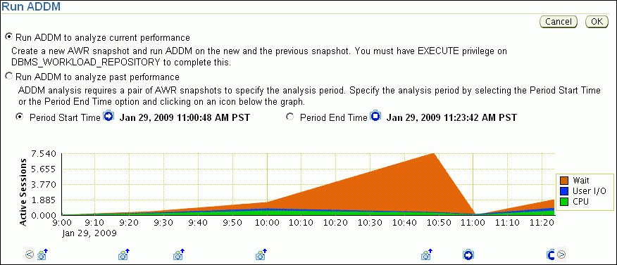

    In this example, the average active sessions with wait events rose at 10:00 a.m., peaking at 10:50 a.m. The number dipped at 11:00 a.m. and then started to rise again at 11:10 a.m.
  3. Select Run ADDM to analyze current instance performance and click OK.

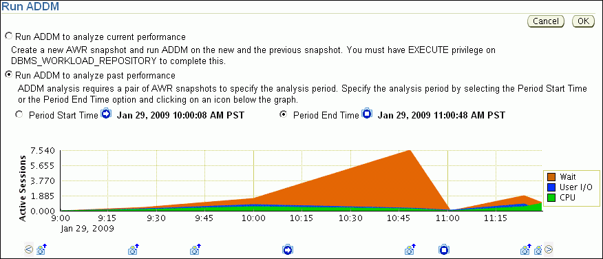

  3. Select Run ADDM to analyze past instance performance.
  4. Specify a time period for analysis by selecting a pair of AWR snapshots. Complete the following steps:
    1. Select Period Start Time.
    2. Below the chart for the starting snapshot, click the snapshot you want to use for the start time.
      A play icon (displayed as an arrow) appears over the snapshot icon.
      In this example, database activity peaked from 10 a.m. to 11 a.m., so the snapshot taken at 10 a.m. is selected for the start time.
    3. Select Period End Time.
    4. Below the chart for the ending snapshot, click the snapshot you want to use for the end time.
      A stop icon (displayed as a square) appears over the snapshot icon.
      In this example, the ending snapshot is at 11:00 a.m.
    Description of run_addm_past.gif follows
  5. Click OK.

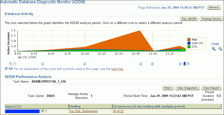

    After ADDM completes the analysis, the Automatic Database Diagnostic Monitor (ADDM) page appears with the results of the ADDM run.

If you ran ADDM manually to analyze current or historical database performance, the results are displayed on the Automatic Database Diagnostic Monitor (ADDM) page after the ADDM run has completed.

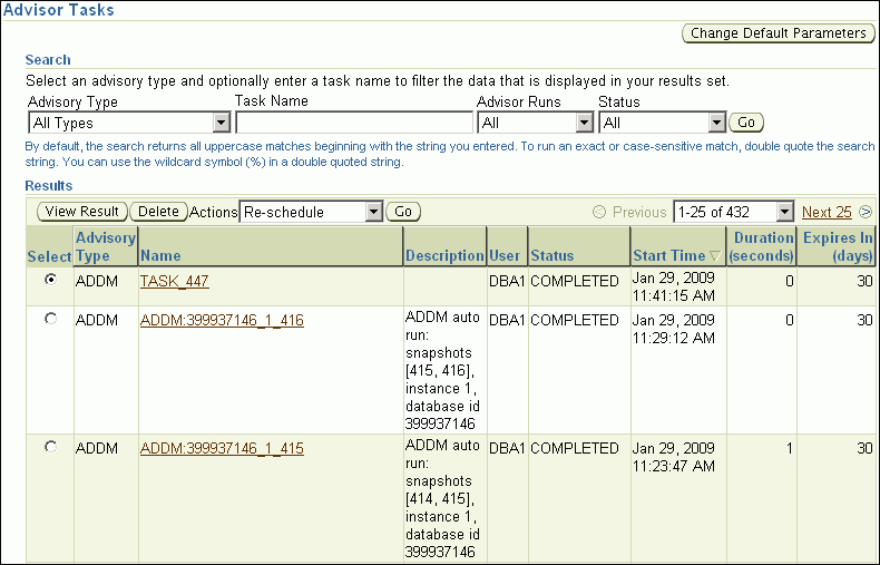

  2. Complete the following steps:
    1. Under Advisor Tasks, select ADDM from the Advisory Type list.
    2. Select the appropriate search criteria.
      For example, you can select All in the Advisor Runs list to view all ADDM tasks.
    3. Click Go.
    Description of advisor_tasks_addm.gif follows
    The ADDM tasks are displayed under Results.
  3. To view an ADDM result, select the desired ADDM task and click View Result.
