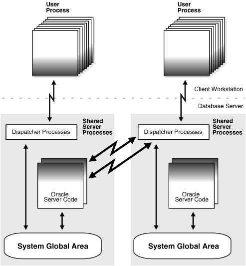

Creating Shared Links to Shared Servers
The configuration illustrated in Figure 32-2 uses shared server processes on the remote server. This configuration eliminates the need for more dedicated servers, but requires the connection to go through the dispatcher on the remote server. Note that both the local and the remote server must be configured as shared servers.
Figure 32-2 Shared Database Link to Shared Server
Description of Figure 32-2 follows
Description of "Figure 32-2 Shared Database Link to Shared Server"

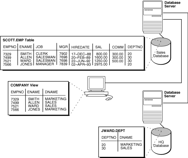

Using Views to Create Location Transparency
Local views can provide location transparency for local and remote tables in a distributed database system.
For example, assume that table emp is stored in a local database and table dept is stored in a remote database. To make these tables transparent to users of the system, you can create a view in the local database that joins local and remote data:
CREATE VIEW company AS
   SELECT a.empno, a.ename, b.dname
   FROM scott.emp a, jward.dept@hq.example.com b
   WHERE a.deptno = b.deptno;
Figure 32-3 Views and Location Transparency
Description of Figure 32-3 follows
Description of "Figure 32-3 Views and Location Transparency"
When users access this view, they do not need to know where the data is physically stored, or if data from more than one table is being accessed. Thus, it is easier for them to get required information. For example, the following query provides data from both the local and remote database table:
SELECT * FROM company;
The owner of the local view can grant only those object privileges on the local view that have been granted by the remote user. (The remote user is implied by the type of database link). This is similar to privilege management for views that reference local data.

Queries including joins, aggregates, subqueries, and SELECT...FOR UPDATE can reference any number of local and remote tables and views. For example, the following query joins information from two remote tables:
SELECT e.empno, e.ename, d.dname
  FROM scott.emp@sales.division3.example.com e, jward.dept@hq.example.com d
  WHERE e.deptno = d.deptno;
In a homogeneous environment, UPDATE, INSERT, DELETE, and LOCK TABLE statements can reference both local and remote tables. No programming is necessary to update remote data. For example, the following statement inserts new rows into the remote table emp in the scott.sales schema by selecting rows from the emp table in the jward schema in the local database:
INSERT INTO scott.emp@sales.division3.example.com
  SELECT * FROM jward.emp;
