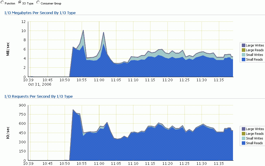

Monitoring I/O
This section describes how to monitor I/O performance. If the throughput on your system is significantly lower than what you expect based on the system configuration (see Chapter 2, "Setting Up Your Data Warehouse System") and your users complain about performance issues, then there could be a performance problem. In a well-configured system that runs a typical data warehouse workload, you expect a large portion of large I/Os and a relatively low latency (lower than 30 ms) for a single block I/O.
To monitor I/O performance:
  1. On the Database Home page, click Performance.
    The Performance page is displayed.
  2. Scroll down the page. Under the list of links, click I/O.
    The I/O page is displayed, displaying I/O Megabytes per Second by Function and I/O Requests per Second by Function.
  3. For details regarding read and write operations, select IO Type.
    I/O details are shown for the following:
    • Large Writes
    • Large Reads
    • Small Writes
    • Small Reads
Figure 9-2 Monitoring I/O
Description of Figure 9-2 follows
Description of "Figure 9-2 Monitoring I/O"
