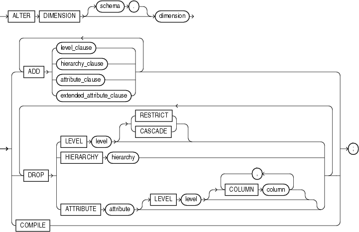

Use the ALTER DIMENSION statement to change the hierarchical relationships or dimension attributes of a dimension.

ADD
The ADD clauses let you add a level, hierarchy, or attribute to the dimension. Adding one of these elements does not invalidate any existing materialized view.
Oracle Database processes ADD LEVEL clauses prior to any other ADD clauses.
DROP
The DROP clauses let you drop a level, hierarchy, or attribute from the dimension. Any level, hierarchy, or attribute you specify must already exist.
Within one attribute, you can drop one or more level-to-column relationships associated with one level.
Restriction on DROP If any attributes or hierarchies reference a level, then you cannot drop the level until you either drop all the referencing attributes and hierarchies or specify CASCADE.
CASCADE  Specify CASCADE if you want Oracle Database to drop any attributes or hierarchies that reference the level, along with the level itself.
RESTRICT Specify RESTRICT if you want to prevent Oracle Database from dropping a level that is referenced by any attributes or hierarchies. This is the default.
