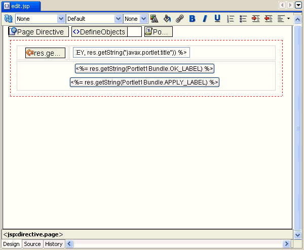

  4. Open edit.jsp in the visual designer and click the Design tab. Notice that the JSP consists of a form field, a form input field, and two form button fields, as shown in Figure 19-2.
    Figure 19-2 edit.jsp in the Design View
    This image shows the Design view of Edit.jsp.
    Description of "Figure 19-2 edit.jsp in the Design View"
