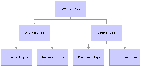

Hierarchy of financial transactions
A financial transaction is categorized into three hierarchical levels:
Journal types—such as assets, sales, purchases, or financial journals—are the highest category level.
Journal codes subdivide journal types and are assigned to only one journal type, for example, subdividing the sales journal into domestic sales and export sales.
Document types, located within journal codes, are assigned to only one journal code.
Document sequencing occurs at either the journal code level or the document type level within a journal code. If sequencing occurs at the journal code level, all document types within a journal code share the same sequence number range. If sequencing occurs at the document type level, each document type has its own sequence number range. You can reset document sequence numbers at the schedule that you define for each journal code and document type within a journal code. Because you can derive journal type and journal code values from the document type, document type is the only required field of these three in financial transactions.
