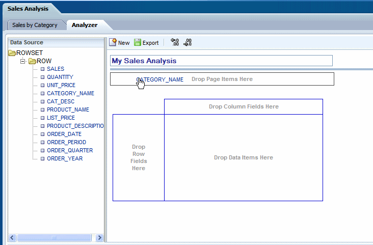

  2. To filter by CATEGORY_NAME, drag the item to the Page Items region, as shown in the following figure:

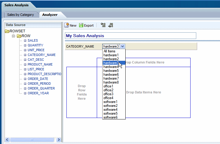

    Now you can choose a value from the CATEGORY_NAME list to filter the page data as shown in the following figure:
