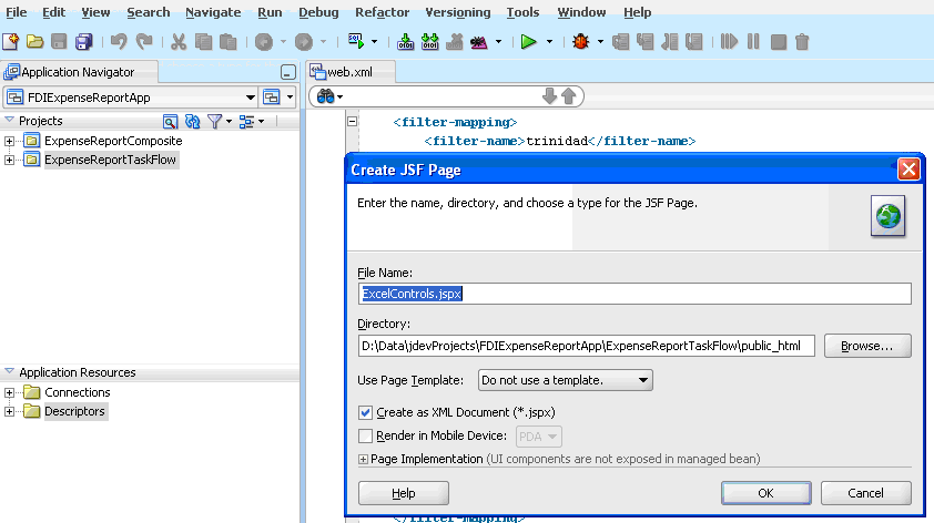

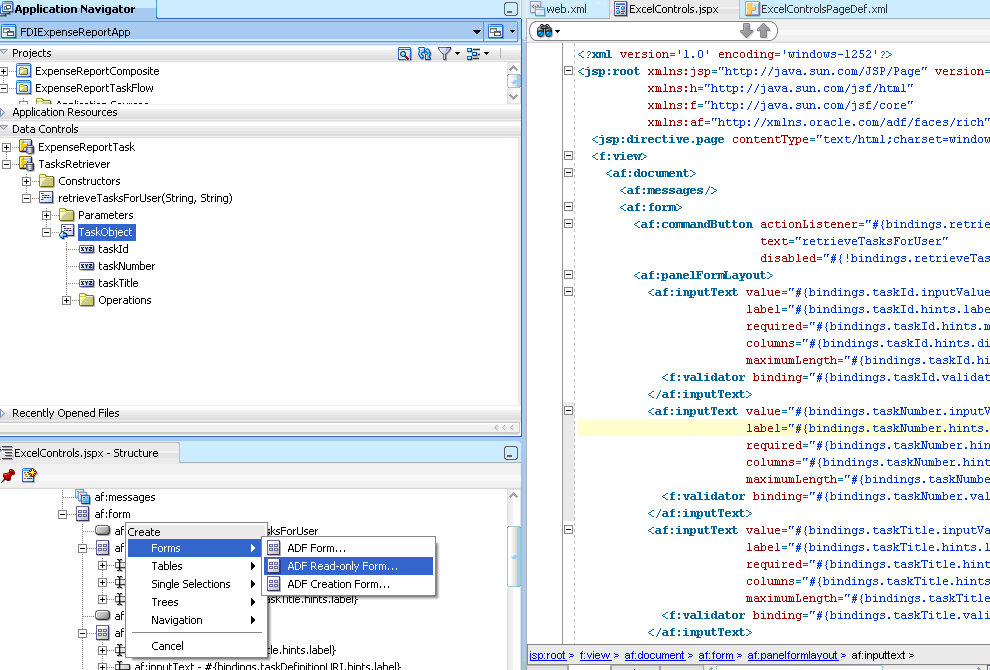

33.1.2 How to Create a Dummy JSF Page
In this task you generate a page definition file. Note that the actual layout generated in the JSF file is not of a concern. Instead, you simply want to generate a page definition file that contains these controls and actions. This page definition is used later in the Excel file.
To create a dummy JSF page:
  1. In JDeveloper, from the File menu, select New. The New Gallery dialog appears.
  2. In the Categories section, from the Web Tier node, select JSF. The corresponding items appear in the Items pane.
  3. In the Items pane, select JSF Page and then click OK. The Create JSF Page dialog appears.
  4. Fill in the various fields by following the instructions in the online Help for this dialog.
  5. When prompted, drag and drop from the Component Palette the controls and fields you are interested in using in the Excel document.
For an example of how to perform this task, see "Task 3: Create a Valid Page Definition File to Be Used in the Excel Workbook".

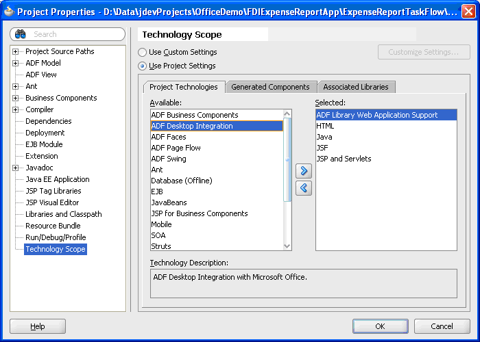

33.1.3 How to Add Desktop Integration to Your Oracle JDeveloper Project
To add Oracle ADF Desktop Integration to the technology scope of your project, use the Project Properties dialog in JDeveloper.
To add Oracle ADF Desktop Integration to your project:
  1. In the Application Navigator, right-click the project to which you want to add the Oracle ADF Desktop Integration module and choose Project Properties from the context menu.
    If your application uses the Fusion Web Application (ADF) application template, you select the ViewController project. If your application uses another application template, select the project that corresponds to the web application.
  2. In the Project Properties dialog, select Technology Scope to view the list of available technologies.
  3. Choose the ADF Desktop Integration and ADF Library Web Application Support project technologies and add them to the Selected Technologies list.
  4. Click OK.

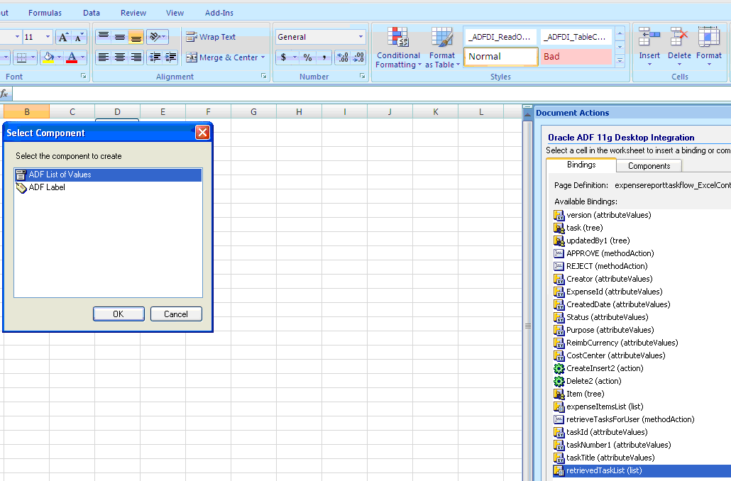

33.1.7 How to Install the Oracle ADF-Desktop Integration Plug-in
To perform this installation, follow the steps in "Task 4: Prepare the Excel Workbook":

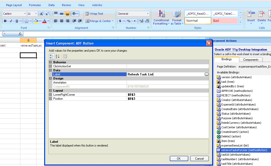

33.1.8 How to Specify the User Interface Controls and Create the Excel Workbook
For instructions see "Task 4: Prepare the Excel Workbook".

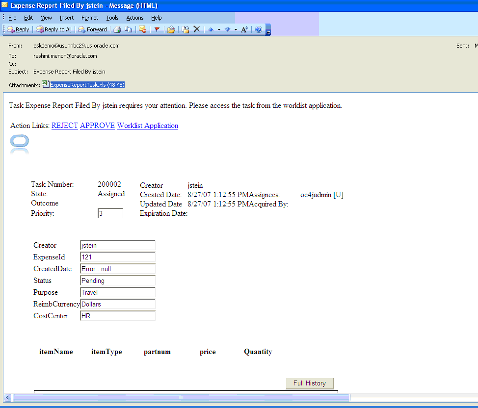

33.2 Attaching Excel Workbooks to Human Task Workflow Email Notifications
As an alternative to using the worklist application, you can attach an Excel workbook with task details as part of a Human Task workflow email notification. In this case, the user receives an email about a new task. This email has an Excel workbook attached, and, when the user opens the attachment, she is directed to a login page--similar to that for the worklist application. The Excel workbook includes such task details as task ID, payload, and so on. Buttons correspond to the actions the user can perform, and clicking one of them invokes the corresponding BPEL process.
33.2.1 Enabling Attachment of Excel Workbooks to Human Task Workflow Email Notifications
To enable this functionality, do the following:
  1. In Oracle JDeveloper, create an ADF task flow that corresponds to a particular Human Task activity in a BPEL process.
  2. Modify the settings in the ADF-DI-enabled Excel sheet to point to the server on which the task flow is deployed, then saves this Excel sheet as part of the .war file packaged for the ADF task flow. The steps for doing these things are covered in "Example: Attaching an Excel Workbook to Email Notifications" . Later, you use the page definition files generated in "How to Create a Dummy JSF Page"
    Packaging the Excel workbook with the ADF task flow assumes that there is a one-to-one correspondence between the ADF task flow and the Excel sheet used for a workflow.
  3. Enable the ADF task flow project for desktop integration and deploys it to the server.

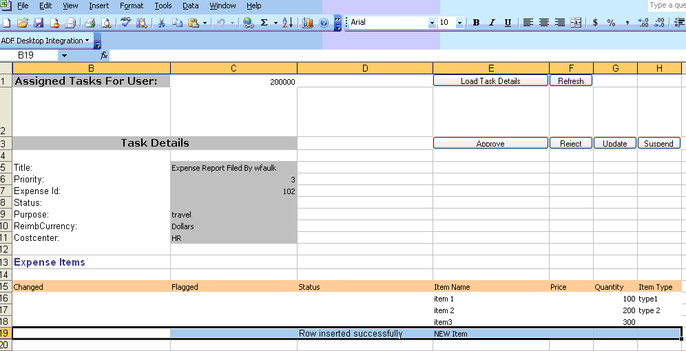

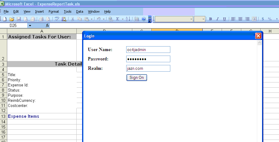

33.2.2 What Happens During Runtime When You Enable Attachment of Excel Workbooks to Human Task Workflow Email Notifications
Note the following end-user experience during runtime:
  • A user receives an email notification regarding a new task, with the Excel attachment. When the attachment is opened, the user is directed to a login page and prompted to enter username and password. This login page is similar to the login page for worklist application.
  • The Excel workbook loads up with the task details—for example, task identifier, payload. There are buttons corresponding to actions the user can take. Clicking one of these buttons starts the BPEL process in which the task is a step.
Note the following runtime behaviors:
  • The Excel workbook is added as an attachment only when the flag “include task attachments” for the corresponding task is set to true.
  • Before adding the Excel workbook as an attachment, runtime verifies that a digital signature is not enabled for the workflow.
  • When the ADF task flow is deployed to the server, such data as the hostname and port number of the task flow URI is registered in the database.
  • When an email notification is created, runtime retrieves from the database the hostname and port number of the application server and the context root of the task flow application. It uses this information to find the Excel workbook, workflow_name.xls.

  2. Add Oracle ADF Desktop Integration to the project by following the instructions in "How to Add Desktop Integration to Your Oracle JDeveloper Project".
    Figure 33-2 illustrates the Oracle JDeveloper Project Properties dialog when you are adding Oracle ADF Desktop Integration to your project.
    Figure 33-2 Oracle JDeveloper Project Properties Dialog
    Description of Figure 33-2 follows
    Description of "Figure 33-2 Oracle JDeveloper Project Properties Dialog"

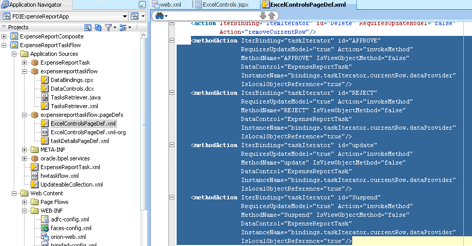

  4. Confirm that the project's deployment descriptor—namely, web.xml—is modified to include the following entries:
    • A servlet named adfdiRemote
    • A filter named adfdiExcelDownload
    • A MIME mapping for Excel files
    The previous list is not exhaustive. Adding “ADF Desktop Integration” and “ADF Library Web Application Support” to the project makes other changes to web.xml. Here is a sample snippet of the deployment descriptor:

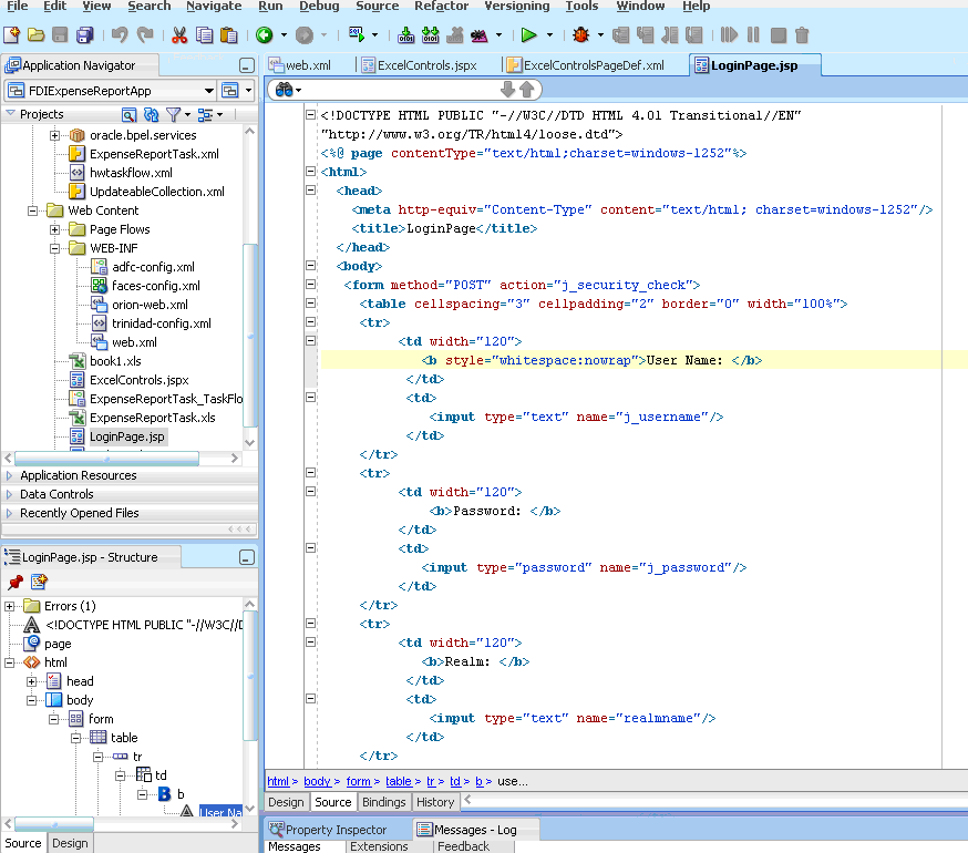

  2. Create a login page for the application:

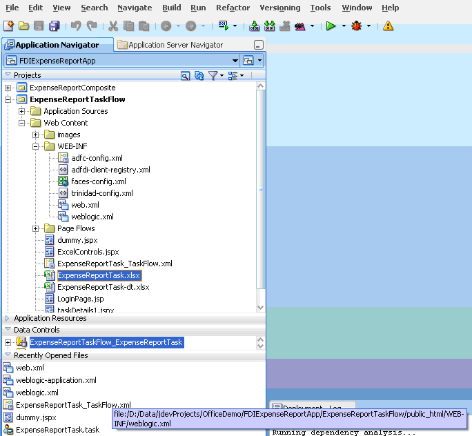

    1. From the directory ExpenseReportTaskFlow\public_html\ copy the file LoginPage.jsp to the directory project_home\public_html.
    2. Refresh the view in Oracle JDeveloper.
    3. Verify that the file LoginPage.jsp is visible. It should look like what is illustrated in Figure 33-3.
      Figure 33-3 Oracle JDeveloper: Login.jsp File
      This graphic is described in the text.
      Description of "Figure 33-3 Oracle JDeveloper: Login.jsp File"

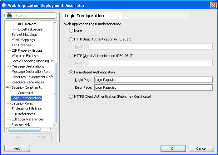

        <login-config>
            <auth-method>FORM</auth-method>
            <realm-name>jazn.com</realm-name>
            <form-login-config>
                <form-login-page>/LoginPage.jsp</form-login-page>
                <form-error-page>/LoginPage.jsp</form-error-page>
            </form-login-config>
        </login-config>
        <security-role>
            <role-name>Administrators</role-name>
        </security-role>
    Figure 33-4 shows how these entries appear graphically in the Application Deployment Descriptor dialog.
    Figure 33-4 Oracle JDeveloper: Application Deployment Descriptor
    Description of "Figure 33-4 Oracle JDeveloper: Application Deployment Descriptor"

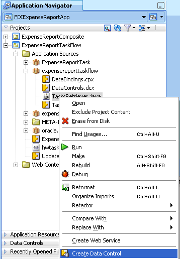

  1. Create a new Java class by following these steps:
    1. Select Technologies, then select General, then select Simple Files, then select Java Class.
    2. Specify details as follows:
      Package: (leave it as default)
      Extends: oracle.bpel.services.workflow.client.worklist.excel.TasksRetriever (click Browse to select this class)
      This creates a new Java class <default-package>.TasksRetriever.

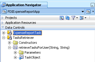

  1. Create a data control for this newly created Java class. This data control provides access to an API that retrieves all assigned tasks for a user. Figure 33-5 shows the menu involved in creating the data control.
    Figure 33-5 Oracle JDeveloper: Creating a Data Control
    This illustration is described in the text.
    Description of "Figure 33-5 Oracle JDeveloper: Creating a Data Control"
  2. Verify that the newly created Data Control TasksRetriever is visible in the Data Control palette in the lower portion of the Application Navigator. Figure 33-6 shows the Application Navigator with the Data Control palette expanded.
    Figure 33-6 Oracle JDeveloper: Application Navigator with Data Control Palette Expanded
    Description of "Figure 33-6 Oracle JDeveloper: Application Navigator with Data Control Palette Expanded"
  3. Create a new JSF JSP page--namely, ExcelControls.jspx. This generates a page definition that can be used by ADF-DI while authoring the Excel document. Figure 33-7 provides details.
    Figure 33-7 Oracle JDeveloper: Creating a JSF JSP Page
    Description of Figure 33-7 follows
    Description of "Figure 33-7 Oracle JDeveloper: Creating a JSF JSP Page"

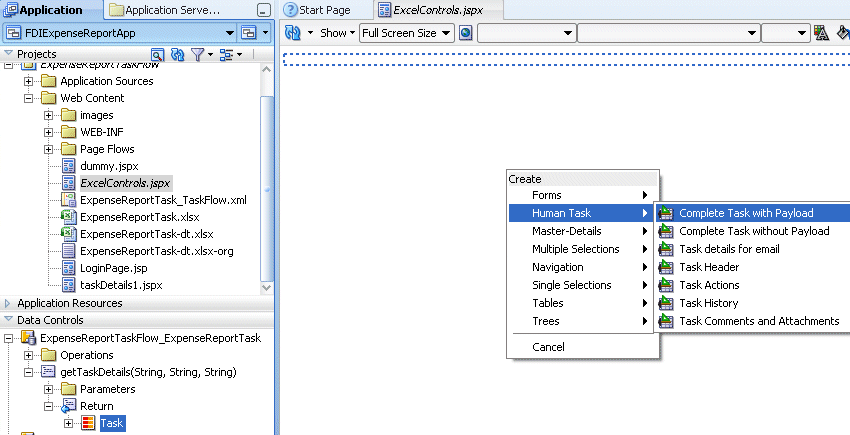

  4. Drag and drop the task node from the Data Controls palette to ExcelControls.jspx. Select Human Task, then select Complete task with payload. Figure 33-8 illustrates the sequence of menus you use. Click OK on windows that pop up.
    Figure 33-8 Oracle JDeveloper: Creating an ADF Read-Only Form
    Description of "Figure 33-8 Oracle JDeveloper: Creating an ADF Read-Only Form"
  5. Drag and drop one or more task actions to the .jspx file. In this example, as illustrated in Figure 33-9, the actions 'Approve', 'Reject', 'update' and 'Suspend' are added to create the entries in the page definition.
    Figure 33-9 Oracle JDeveloper: Configuring the Page Definition File
    Description of "Figure 33-9 Oracle JDeveloper: Configuring the Page Definition File"

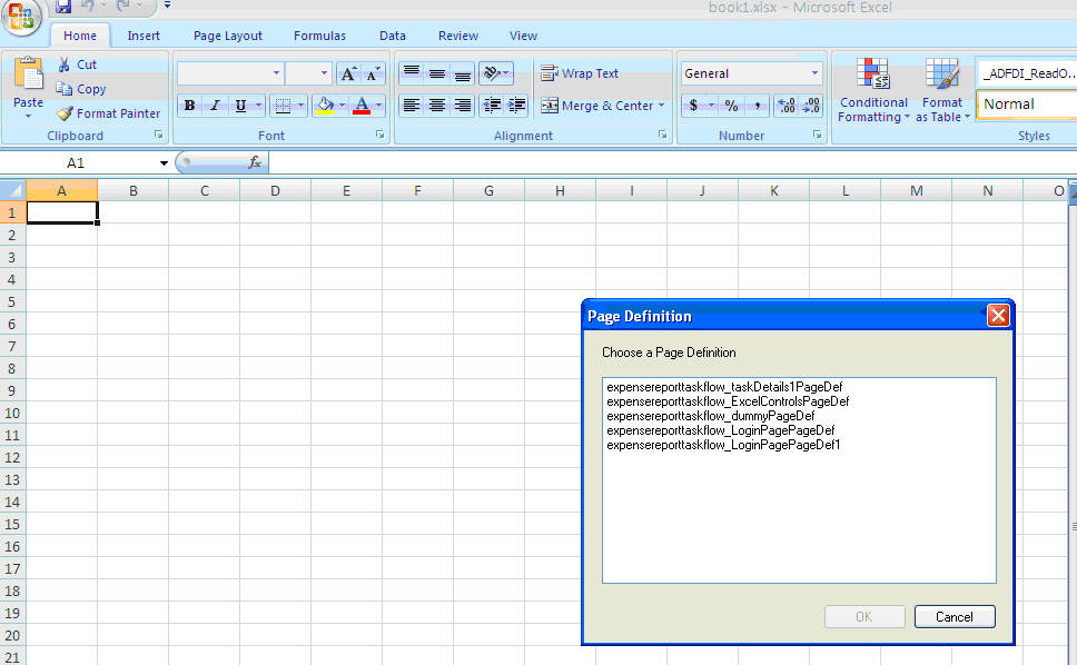

  6. Open the Excel workbook and choose a page definition. In this use case, the page definition is expensereporttaskflow_ExcelControlsPageDef. Figure 33-11 provides details.
    Figure 33-11 Excel: Page Definition Dialog
    Description of Figure 33-11 follows
    Description of "Figure 33-11 Excel: Page Definition Dialog"

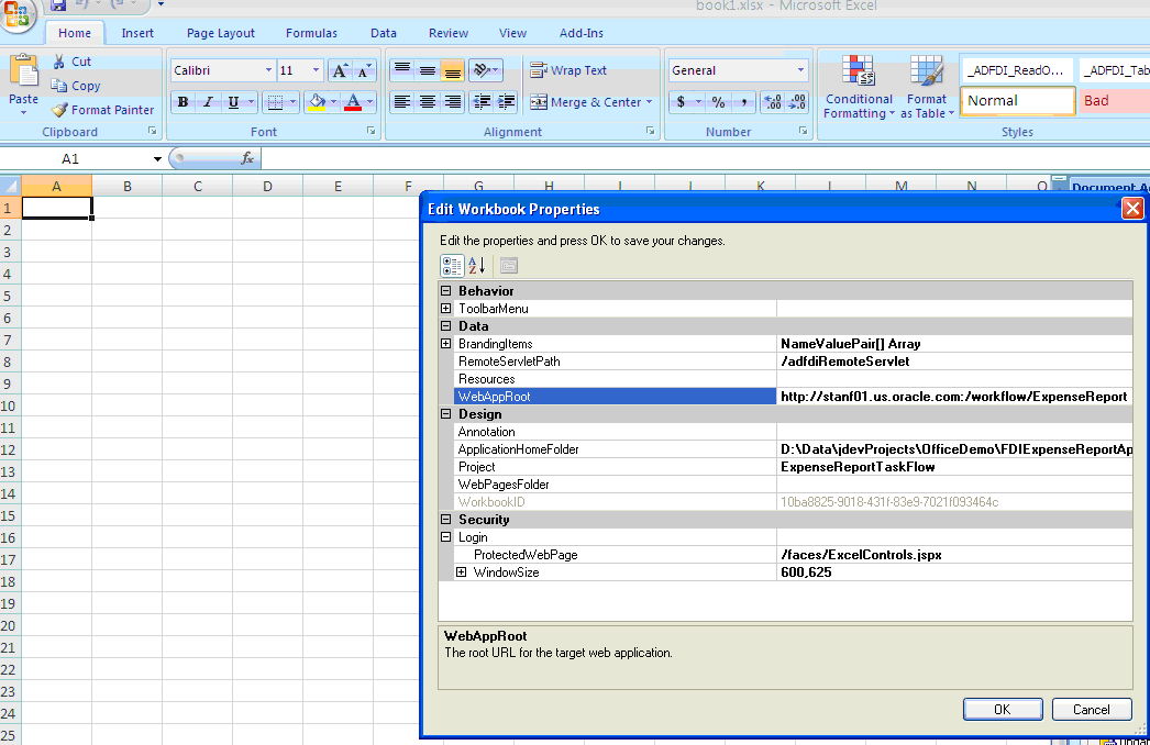

  7. In the Document Actions pane, select Workbook Properties.
  8. Specify ProtectedWebPage: http://application_server:port//workflow/application_name/faces/app/logon. (Note that this URL is protected and triggers form authentication. See Section 33.2.3.2, "Task 2: Set up Authentication." )
    Specify WebAppRoot: http://application_server:port//workflow/application_name. Click OK.
    Figure 33-12 provides details.
    Figure 33-12 Excel: Setting WebAppRoot
    Description of "Figure 33-12 Excel: Setting WebAppRoot"
  9. From the Document Actions pane, insert ADF Bindings to create the corresponding fields in the Excel workbook. For further details on specific components refer to the Oracle Fusion Middleware Desktop Integration Developer's Guide for Oracle Application Development Framework. For instance, insert binding retrievedTaskList to create a list of values. Figure 33-13 provides details.
    Figure 33-13 Excel: Creating s List of Values
    Description of "Figure 33-13 Excel: Creating s List of Values"
  10. Insert a methodAction binding to create a button in Excel. Figure 33-14 provides details.
    Figure 33-14 Excel: Inserting a methodAction Binding
    Description of Figure 33-14 follows
    Description of "Figure 33-14 Excel: Inserting a methodAction Binding"

    A completed Excel workbook for an expense report application looks something like what you see in Figure 33-15:
    Figure 33-15 Excel Workbook Integrated with Oracle ADF-DI
    Description of "Figure 33-15 Excel Workbook Integrated with Oracle ADF-DI"

  1. Invoke the deployed SOA composite and verify that the assignee receives the Excel workbook as part of the email notification. Figure 33-18 provides details.
    Figure 33-18 Excel Workbook Attached to an Email
    Description of Figure 33-18 follows
    Description of "Figure 33-18 Excel Workbook Attached to an Email"
    To successfully open and execute the workbook, the user's desktop host should have the correct security policy and must run the caspol command to grant trust to the client assemblies hosted on the network share.
  2. Open the Excel workbook. You are directed to a login page (This is LoginPage.jsp from Section 33.1.2, "How to Create a Dummy JSF Page.") Enter your security credentials. Figure 33-19 provides details.
    Figure 33-19 Desktop-Integrated Excel Workbook: Login Page
    Description of Figure 33-19 follows
    Description of "Figure 33-19 Desktop-Integrated Excel Workbook: Login Page"
