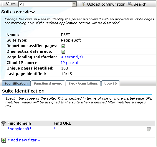

  4. This dialog allows you to specify the Oracle Enterprise architecture upon which the suite is based. The number of options available in this menu depends on the suite packages currently installed. Select the option "PeopleSoft". When ready, click Finish. The suite definition you have specified is displayed. An example is shown in Figure 1-5.
    Figure 1-5 Suite Overview
    Description of Figure 1-5 follows
    Description of "Figure 1-5 Suite Overview"
