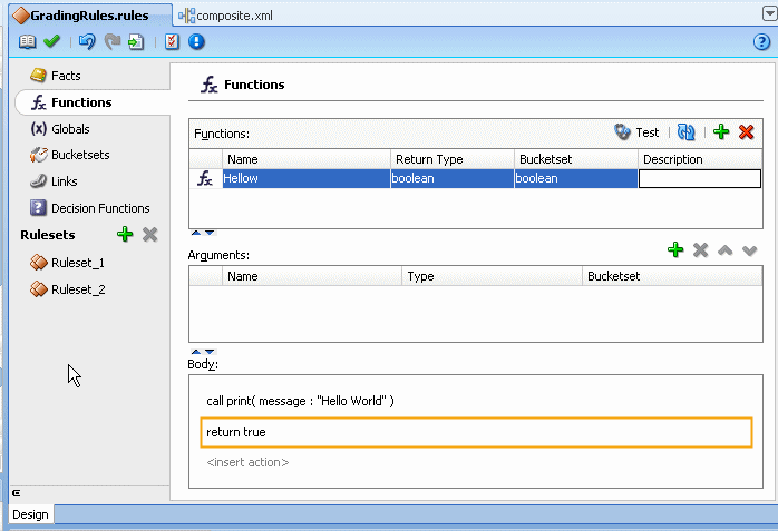

  7. In the Body area, enter the test function body.
    In the body of the function you can call a decision function using assign new to call and get the return value of the decision function. Thus, to test a decision function you create the input data and call the decision function.
    Example 8-1 shows a simple test function that calls print. Figure 8-1 shows the test function definition. For information on adding a test function that calls a decision function, see Section 8.1.3, "How to Test a Decision Function Using an Oracle Business Rules Function".
    Example 8-1 Test Function Body
    call print("Hello World")
    return true
    Figure 8-1 Adding a Test Function
    Description of Figure 8-1 follows
    Description of "Figure 8-1 Adding a Test Function"
  8. In the Functions table select the function and click the Test Function icon.
    The output is displayed in a Function Test Result dialog, as Figure 8-2 shows.

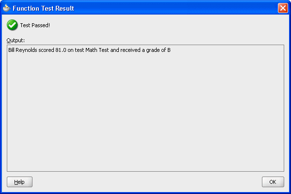

      assign new List resultsList = DecisionFunction_1(testScore)
    Figure 8-3 shows a test function that calls a decision function.
    Figure 8-3 Test Function to Call a Decision Function that Returns a List
    Description of Figure 8-3 follows
    Description of "Figure 8-3 Test Function to Call a Decision Function that Returns a List"
  8. Select the function and click the Test Function icon.
    The function is executed. The output is shown in a Function Test Result dialog, as Figure 8-4 shows.
    Figure 8-4 Test Function Results for Grade Test
    Description of Figure 8-4 follows
    Description of "Figure 8-4 Test Function Results for Grade Test"

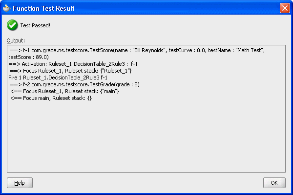

  • As an alternative to the example shown in Figure 8-3, you can enter the function body that is shown in Example 8-2. This function runs and shows the RL.watch.all() output. The dialog shows "Test Passed" when the grade is in the B range as shown in Figure 8-5. The dialog shows "Test Failed" when the grade asserted is not in the B range, as shown in Figure 8-6.
    Example 8-2 Function Body with True or False Return Value
    call RL.watch.all()
    assign new TestScore testScore = new TestScore()
    modify (testScore, name: "Bill Reynolds", testName: "Math Test", testScore: 81)
    assign new TestGrade testGrade = (TestGrade)DecisionFunction_1(testScore).get(0)
    return testGrade.grade == Grade.B
    For the testScore value 81, this function returns "Test Passed" as shown in Figure 8-5. For the testScore value 91, this returns "Test Failed", as shown in Figure 8-6.
    Figure 8-5 Test Passed Test Function Output
