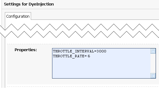

In the Administration Console, you assign values to dyes by typing them into the Properties field of the Settings for DyeInjection page. For instructions, see "Configure diagnostic monitors in a diagnostic system module" in the Oracle WebLogic Server Administration Console Help.
Figure 12-1 Setting Dye Values in the Administration Console
Description of Figure 12-1 follows
Description of "Figure 12-1 Setting Dye Values in the Administration Console"

THROTTLE Dye Flag
The THROTTLE dye flag can be used to control the volume of incoming requests that are dyed. THROTTLE is configured differently from the other flags, and WLDF uses it differently. See Using Throttling to Control the Volume of Instrumentation Events, for more information.

Configuring the THROTTLE Dye
Unlike other dyes in the dye vector, the THROTTLE dye is configured through two properties.
  • THROTTLE_INTERVAL sets an interval (in milliseconds) after which a new incoming request is dyed with the THROTTLE dye.
    If the THROTTLE_INTERVAL is greater than 0, the DyeInjection monitor sets the THROTTLE dye flag in the dye vector of an incoming request if the last request dyed with THROTTLE arrived at least THROTTLE_INTERVAL before the new request. For example, if THROTTLE_INTERVAL=3000, the DyeInjection monitor waits at least 3000 milliseconds before it will dye an incoming request with THROTTLE.
  • THROTTLE_RATE sets the rate (in terms of the number of incoming requests) by which new incoming requests are dyed with the THROTTLE dye.
    If THROTTLE_RATE is greater than 0, the DyeInjection monitor sets the THROTTLE dye flag in the dye vector of an incoming request when the number of requests since the last request dyed with THROTTLE equals THROTTLE_RATE. For example, if THROTTLE_RATE = 6, every sixth request is dyed with THROTTLE.
You can use THROTTLE_INTERVAL and THROTTLE_RATE together. If either condition is satisfied, the request is dyed with the THROTTLE dye.
If you assign a value to either THROTTLE_INTERVAL or THROTTLE_RATE (or both, or neither), you are configuring the THROTTLE dye. A THROTTLE configuration setting in the Administration Console is shown in the following figure.
Figure 12-4 Configuring the THROTTLE Dye
Description of Figure 12-4 follows
Description of "Figure 12-4 Configuring the THROTTLE Dye"
Example 12-3 shows the resulting configuration in the descriptor file for the diagnostics module.
Example 12-3 Sample THROTTLE Configuration in the DyeInjection Monitor, in DIAG_MODULE.xml
