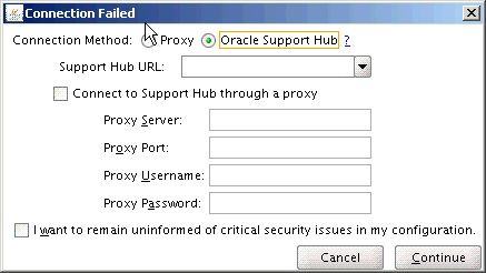

The Connection Failed dialog box, with Proxy connection method selected (Figure 3-2), appears when Oracle Universal Installer determines there is no connectivity to Oracle.
Figure 3-2 Connection Failed - Proxy Method

Enter the Oracle Support Hub configuration details as follows.
On the Connection Failed dialog box:
Choose the appropriate Oracle Support Hub from the Existing Oracle Support Hub URL drop-down list or enter the URL for the Oracle Support Hub, for example, http://host123.company.com:8888.
Decide whether you need to connect to the Oracle Support Hub by way of a proxy server. If so:
Check the 'Connect Using Proxy Server' box.
Enter the host name of the proxy server. For example, you can specify the proxy server setting as follows:
Proxy Server: www-proxy.example.com
Enter the port number of the proxy server. For example, you can specify the proxy port as follows:
Port: 98
If the proxy server requires authentication, you must specify the credentials in the Proxy Username and Proxy Password fields.
Click Continue to validate that you can connect to Oracle.
If the connection is not successful, you remain on the Connection Failed dialog box. Either enter the Oracle Support Home URL or, add or correct the proxy server information. If no connection is possible, check the I want to remain uninformed of critical security issues in my configuration checkbooks. Oracle Configuration Manager will be installed in disconnected mode.
If the connection is successful, Oracle Configuration Manager validates the My Oracle Support User Name (e-mail address) and My Oracle Support Password. See Section 3.3.1, "Providing Credentials" for additional information.
