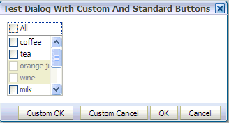

Dialogs can use built-in and custom buttons.
custom buttons
Dialogs can contain many different components.
dialog with table

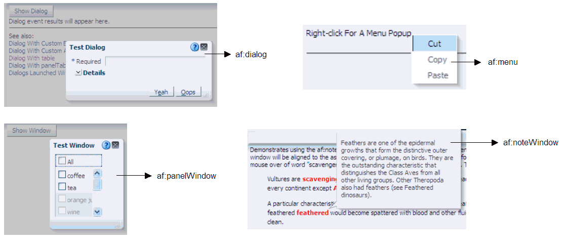

Dialogs, windows, and context menus all use the af:popup component to display content in a secondary widnow that belongs to the parent window. You can place the following components inside a popup:
  • The af:dialog component delivers events when the OK, Yes, and No and Cancel actions are activated.
  • The af:panelWindow component is similar to a dialog, but does not support events.
  • Context menus are rendered by the af:menu component and menu items are rendered by the af:commandMenuItem component.
  • The af:noteWindow component displays read-only information for the associated component.

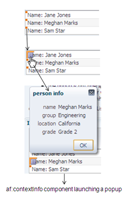

  • The af:contextInfo component displays a small orange square that alerts users to the fact that additional information is available in a popup component. When the user clicks the square, the popup displays.
