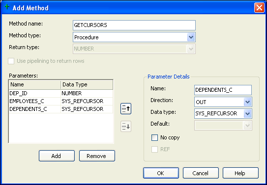

  5. In the Add Method window, enter Method Name GETCURSORS, and change Method Type to Procedure.
  6. Under Parameters, click Add.
    This starts the process of adding parameters.
    Under the Parameter Details group on the right, enter these three parameters. Click Add before each parameter that you need to add.
    • Name: DEP_ID, Direction: select IN , Data Type: select NUMBER.
    • Name: EMPLOYEES_C, Direction: select OUT, Data Type: select SYS_REFCURSOR.
    • Name: DEPENDENTS_C , Direction: OUT, Data Type: select SYS_REFCURSOR.
    Description of procedure3.gif follows
  7. Click OK when you finish adding parameters.
