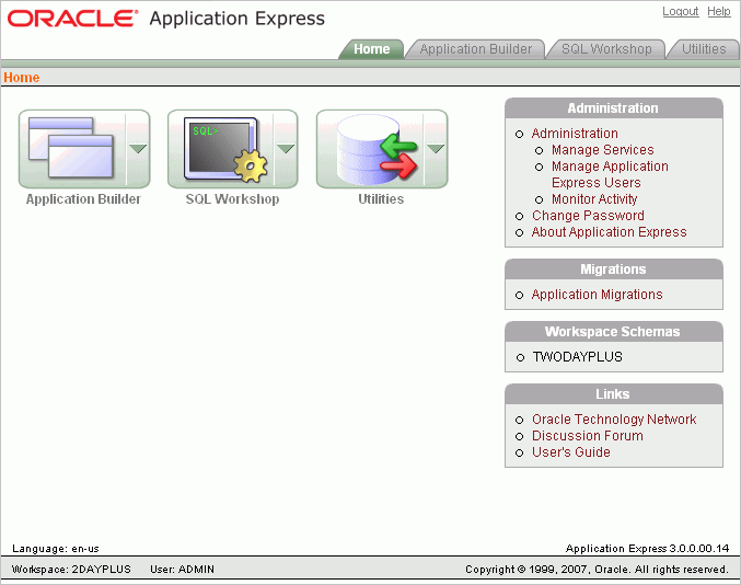

When you log in to Oracle Application Express, the Workspace home page appears.
Description of workspace4.gif follows
Take a few minutes to explore the product. The following three large icons appear in the center of the page:
Note that your workspace and username appear in the lower left corner.

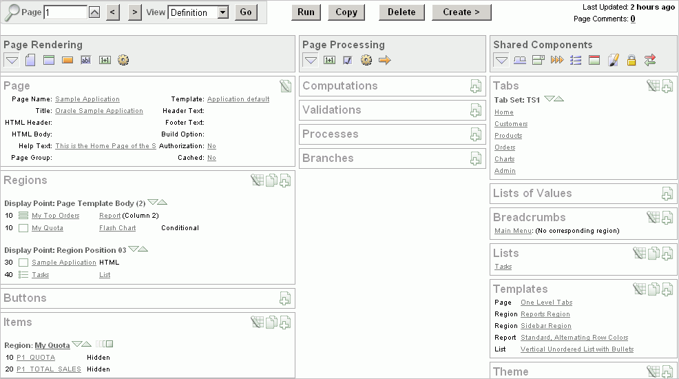

A page is the basic building block of an application. Pages also contain user interface elements such as tabs, lists, buttons, items, and regions. To see the definition of each page belonging to your application, you use the Page Definition page.
Description of gtst_pgdef1.gif follows
The Page Definition contains three main areas:
