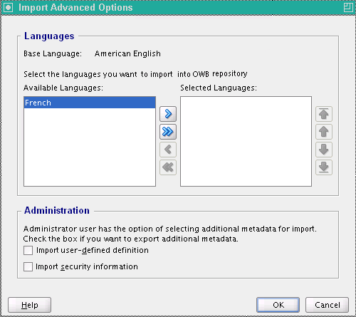

  3. In the Metadata Import dialog box:
    • Click Browse to specify the File Name (name and location) of the import file.
    • Click Browse to specify the Log File (name and location).
    • Under Object Selection, choose either Import all objects from file or Import selected objects from file.
    • Under Import Option, select one of Create new metadata only, Update metadata replace existing objects and create new metadata, Merge metadata merge existing objects and create new metadata, or Replace existing objects only.
    • Under Match by, select one of Universal Identifier or Names.
    • [Optional] Click Show Summary to view a summary of the contents of the export file. See "File Summary Dialog Box".
    • [Optional] Click Advanced to import metadata for additional languages, security information, or user-defined properties. See "Import Advanced Options Dialog Box".

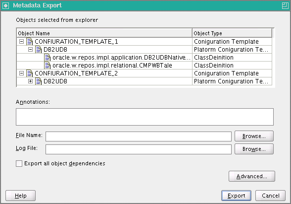

Metadata Export Dialog Box
The Metadata Export dialog box displays the names and the types of the exported objects.
Description of exporting_03.gif follows
The Metadata Export dialog box also contains the following items:
  • Annotations: Use this field to enter any comments about the file that contains the exported objects.
  • File Name: Displays a default path and file name for the export file. You can retain this default or specify a directory and file name. Type the name of the export file to create or click Browse to locate a directory or file. The file name extension commonly used is .mdl.
  • Log File: Use this field to specify the file name and path for the log file that stores diagnostic and statistical information about the export. See "Metadata Loader Log File"
  • Export all object dependencies: Select this option to export all the dependencies of the objects being exported. For example, when you export a table, the location to which the table is deployed is also exported.
    Note that public objects such as locations, public transformations, public experts, public icon sets, or public data rules belong to a project called PUBLIC_PROJECT. You can export the PUBLIC_PROJECT and its objects if the selected exported objects have a dependency on the public objects and if you select the Export all object dependencies option.
  • Advanced: Use the Advanced button to export additional metadata such as user-defined properties, security information, and additional languages. See "Export Advanced Options Dialog Box".
Click Export to export the metadata for the selected objects. The Metadata Export Progress dialog box is displayed. See "Metadata Export Dialog Box" for more information about the contents of this dialog box.
Use the Import Advanced Options dialog box to import any of the following:
  • Additional language metadata
  • User-defined definitions
  • Security information
Description of importing_04.gif follows
This dialog box contains two sections: Languages and Administration.
Languages
The Base Language displays the base language of the repository. By default, data is imported in the base language.
You can specify additional languages to import. The Metadata Import Utility imports the translations of the object for business name and description. The Available Languages list displays the list of languages that are specified in the MDL file. For example, the MDL file contains the additional languages French and Simplified Chinese, but your repository contains only French as the additional language. Then the Available Languages list displays only French. Select the language you want to import and click the arrow to move the language to the Selected Languages list. See "Import Different Base Languages".
Administration
This option is available only if you have administrator privileges and the metadata exists in the MDL file used for import. The options you may choose to import additional metadata are as follows:
  • User-defined definitions: To import the definitions for the user-defined objects and the user-defined properties, select the Import User-defined definitions option.
  • Security Grants: Select Import security information to import security information such as object privileges and role assignments made to users.
If the MDL file contains any of these objects, then you can import this additional metadata.
When you import an MDL file into a new workspace, if you want to inherit the security information from the old workspace, you must import the security information before you import other objects. To do this you need to be connected to the workspace as a user with administrator privileges.
After you make your selections on the Import Advanced Options dialog box, click OK to save your selections and return to the Metadata Import dialog box.
